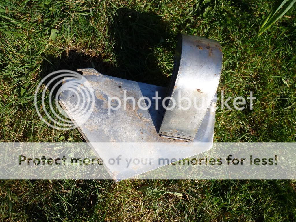

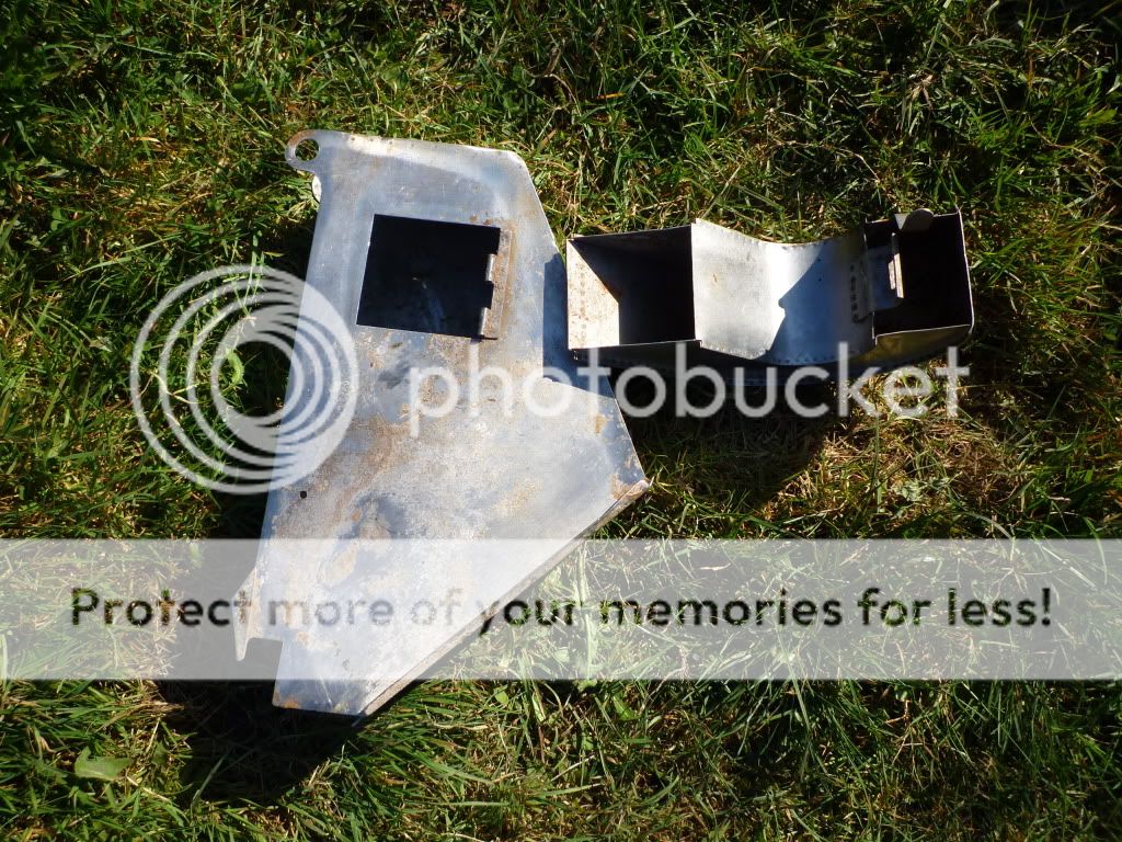

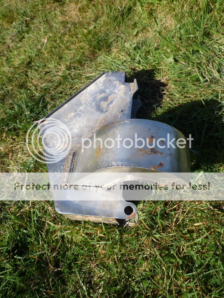

Hello - can anyone ID this please? It's quite a large assembly - It could be American - seems to fit a 50 Cal machine gun. The main body would fit under the weapon and the cartridges would fall out of the bottom of the gun. The spent links would also be fed into the main body by the curved chute.
The chute has the part number ASSY 80921 C-26, the body has 80090-R
It came from a dump of British and US WWII aircraft parts in the UK last year.
Possibly from an American turret? We also found B-25, P-51 link chutes and some US turret parts.

The flexible gun as well as the fixed nose guns in the B-25 had similar chutes like this. There was a canvas bag that would attach to the chute to catch the spent shells and links. I don´t have access to my tech information now but I will check it when I return.

That looks to mount to the MG cradle directly, and catches both the brass casings(ejected through the bottom of the .50) and the disintegrating links, which eject out one side of the receiver. Doesn't look to be too large a capacity though... Unless it feeds into the bag mentioned.

I think the one in the B-26 Marauder is that style.

The Bendix lower used in early B25s had a similar chute used to eject brass and links out of the turret:

Elliot1940 - I was checking some lockers for parts today and found the exact parts you have pictured. I did a some research and found they are acutally the ejection chutes for brass and links for our Bendix upper turret (model A). It clips onto the .50 MG on the back ledge and then connects to the large front pin on the turret gun cradle.
Here is a picture of the service manual, you will note the similarity.
I thank you for posting this topic, I like learning new things on these turrets. I will put these chutes back on our turret guns. I don't know if these chutes are specific to Bendix turrets or if they are common on other gun installations.

Forgot this one, it mentions the part number you found:
