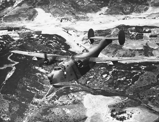

....and, the PB2Y was a..................................................?
........ a PB2Y .................... not a B-24 :rolleyes: :wink:

The point being that the B-24 was developed FROM a flying boat in the first place (sorta (kinda maybe))*
Turning it back would be a waste when we could just get BuAer to order up another dozen Coronados.
* Then there's the Boeing 294/314 thing which went the other way....

Well, the slender "Davis" wing and empnage for the B-24 were adapted from Consolidated's earlier Model 31 XP4Y-1 "Corrigedor" with little change. The PB2Y had a much broader wing, similar to the PBY Catalina (perhaps better for low, slow patrols?)
