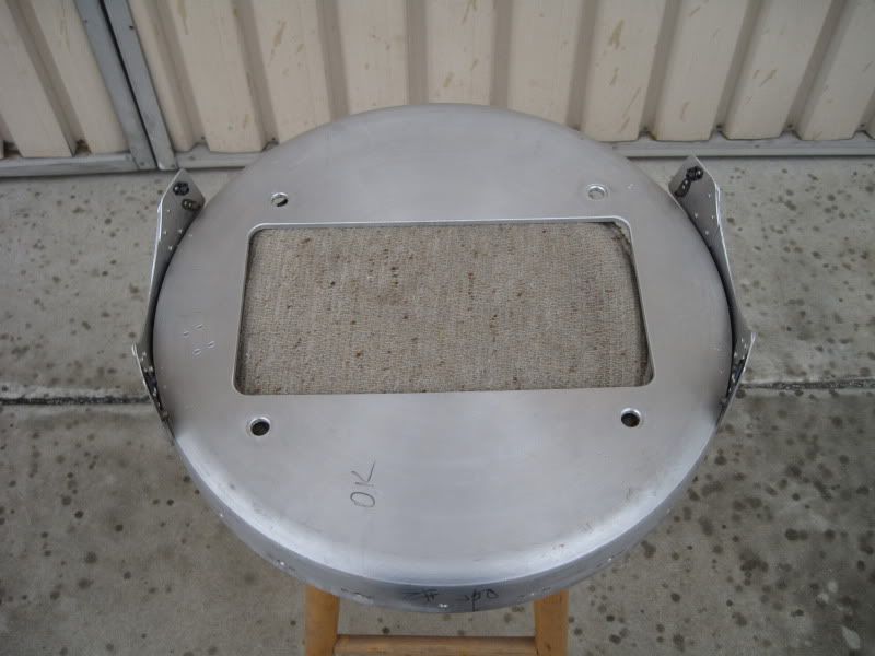

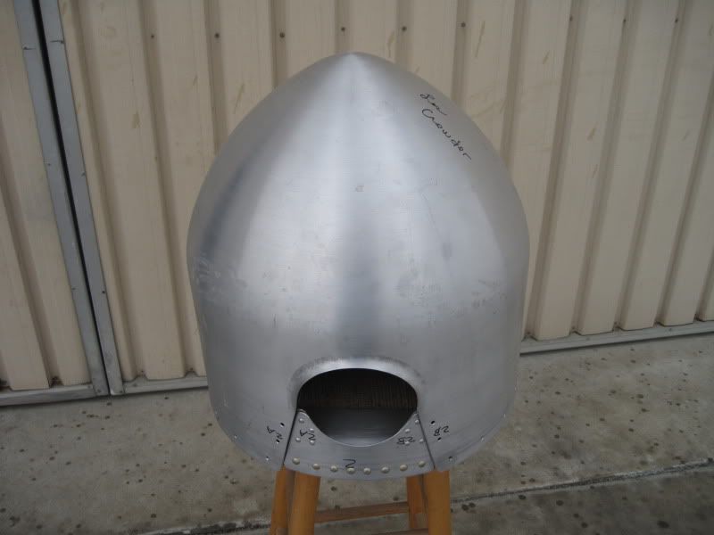

I have in my possession an aluminum T-6 spinner. Unlike the Montgomery spinner, which this mimics from the outside, it is mounted in a more or less conventional general aviation style. There are no horseshoes and the backing plate mounts to the back of the prop hub.
I was told that this spinner was made by Les Crowder, who unfortunately died some years ago.
Does anyone have any information on this spinner? Anyone ever seen another? Anyone actually seen one on a flying T-6?
It is pretty much relegated to static display unless I can find out more info. That would really be a shame since it is so nicely made.
Thanks!
bdk

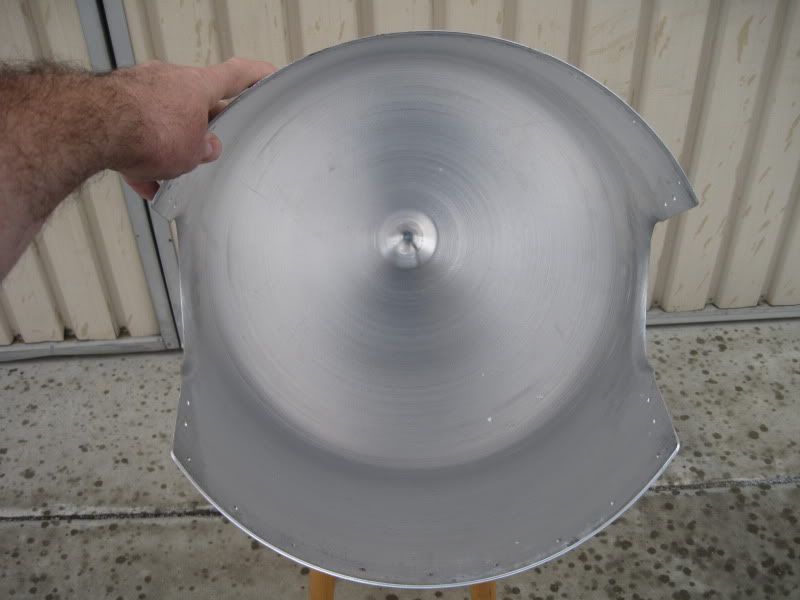

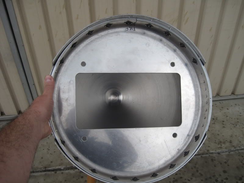

Any pics of the spinner and the inside?
T
 Post subject: Re: Aluminum T-6 Spinner
PostPosted: Sun Mar 20, 2011 2:56 am
Posts: 11336
I'll take some the next time I'm at the airport and post them.

I was hoping someone here might have a copy of a field approval for one. The backing plate obviously doesn't mount to the prop hub directly because not only wouldn't it fit, but then the spinner would be too far forward. The bolts that clamp the forward and aft barrel sections on the hub are special bolts, so to space the spinner aft all I could think was that there was a special nut Les made up to mount the backing plate. Either that or there was another Hamilton Standard bolt from another hub style that was longer that could be used with spacers. The bolt spacing was spot on for a 12D40 hub.
