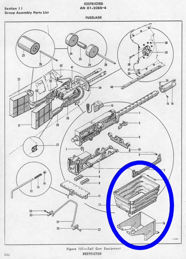

When the B-17 tail guns were fired, were the expended cases and links ejected from the tail, or were they collected and emptied later? I suspect they were ejected from a hole or slot in the bottom of the tail. Does anyone have any pictures or technical drawings showing how the expended cases and links were handled? If they were ejected, did this ever cause problems for the aircraft flying behind in the formation?

PostPosted: Tue Feb 15, 2011 11:08 pm
Joined: Sun May 29, 2005 10:20 pm
Posts: 237
Location: Palatine, Illinois
RAMC181 wrote:
Similar setup on the pre-Cheyenne tail position too.
Chute straight out underneath.
All the best,
PB
This is correct.
Here is a drawing with the "hopper" which helped collect the
spent casings as they fell from the guns and back to earth.
Part #16 was stainless steel. #17 was canvas with piano wire reinforcement.
-Bill
B-17E 41-2595 "Desert Rat" Restoration Team
