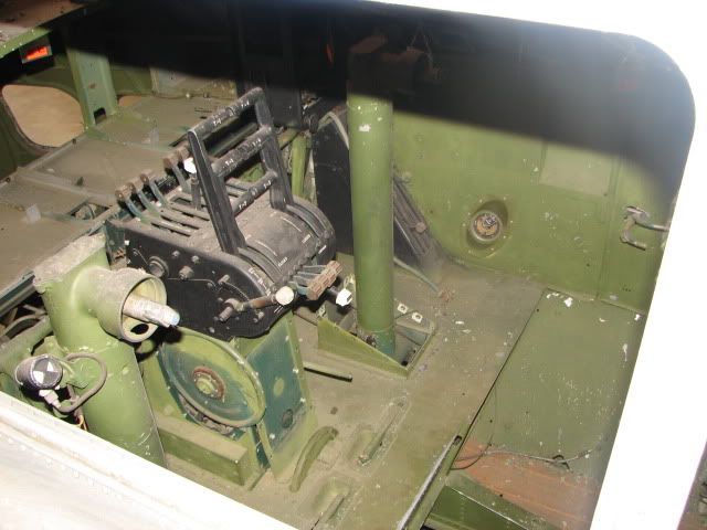

Here's a snapshot of the cockpit of the Memphis Belle..while a lot of it was sprayed Interior Green during her refurbishment in the 1980s, you can still see the original Bronze Green or Dull Dark Green below the throttle console and at the base of the control columns..

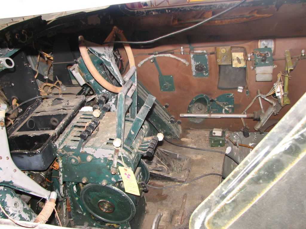

And here's the unrestored cockpit of The Swoose. (the seats and panel have been removed.) You can see the exposed parts are either Bronze Green or DDG. The padding was originally dark green or OD, but has faded to a red-brown.

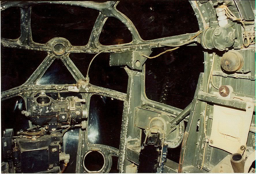

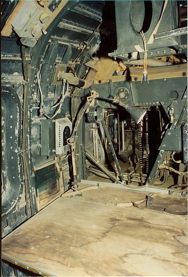

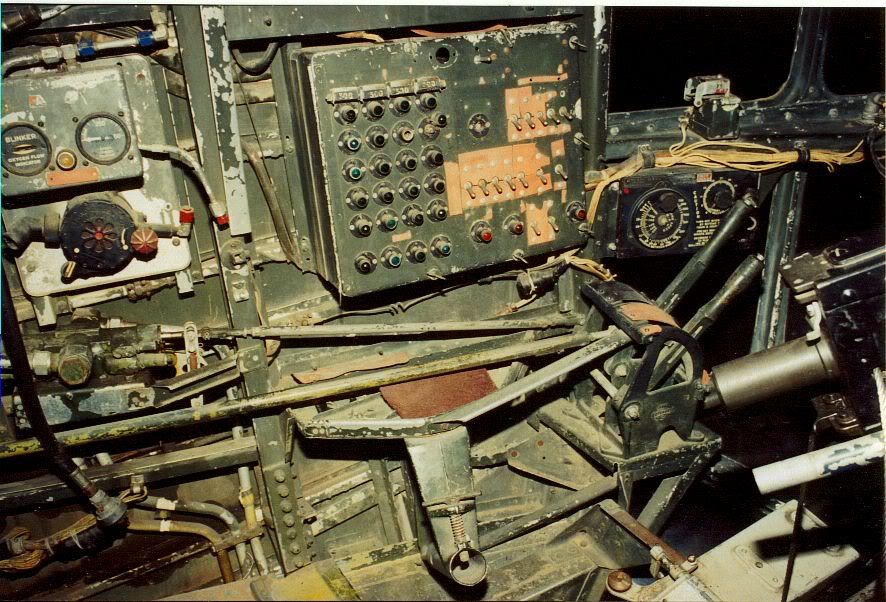

DDG was also used in the cockpit and nose of B-24s. Some years ago the nose compartment of the Strawberry Bitch was painted Interior Green throughout, but here are a few photos taken of her in her original state (courtesy of Karl Hauffe.)
