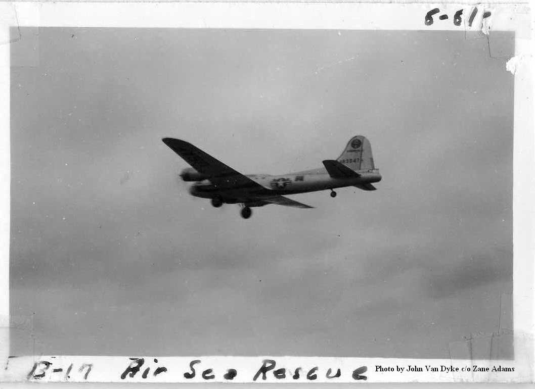

I was looking over my inherited photos and I found these two B-17 shots from Okinawa in 1951
1st one in interesting because it is B-17 - SN 44-83547
David Talichet's airplane is SN 44-83546...they are siblings...kinda cool.

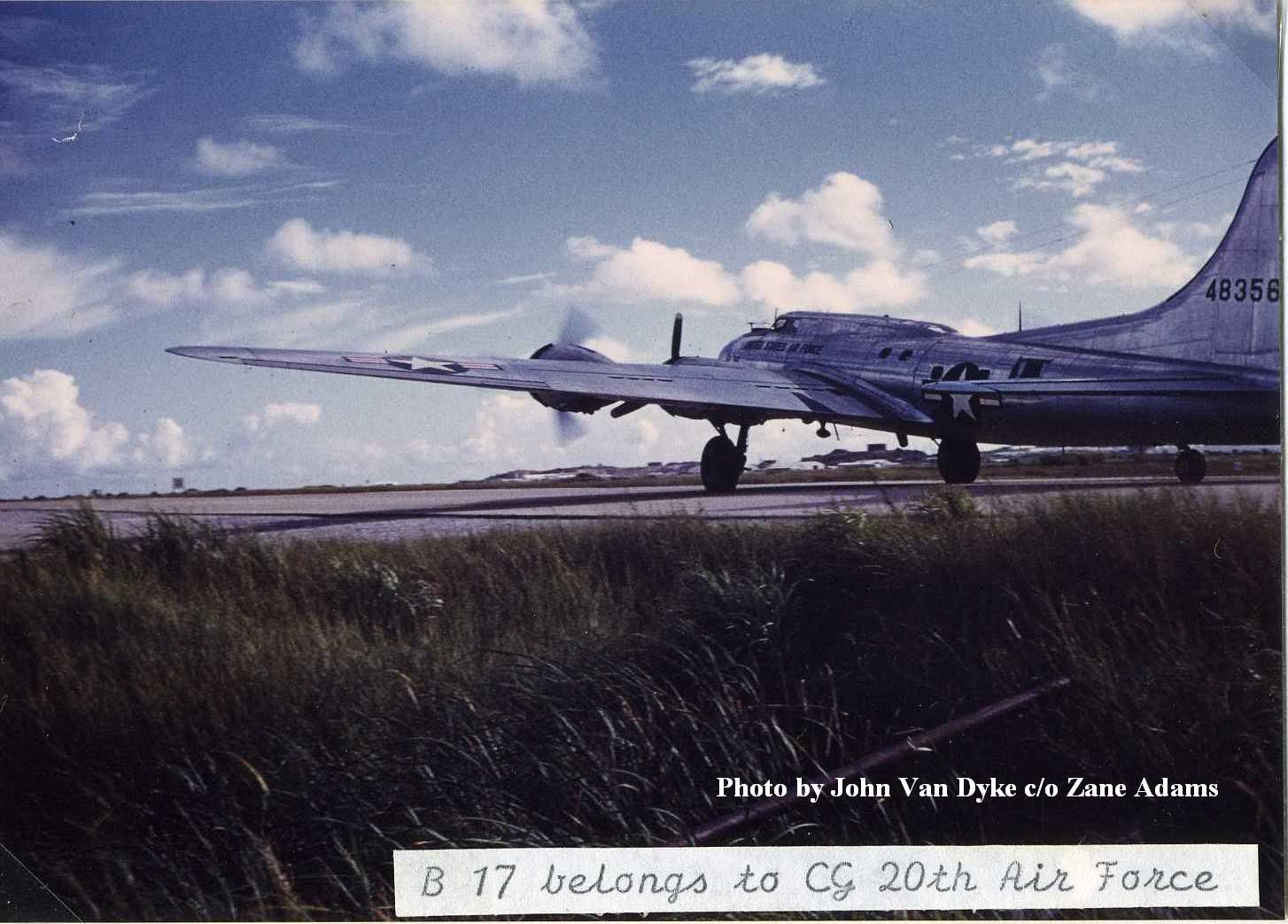

2nd has a partial SN visible on the tail...44-8356_
now doing my amateur on-line research I find:
SN 44-83560 was a drone and seems to have been scrapped in 1959
SN 44-83565 was a drone and had an accident at Eglin AFb in 1950
SN 44-83567 crashed near Raton NM ...no date
SN 44-83568 crashed on the Azores in 1946
and
Sn 44-83563 is now Fuddy Duddy
I estimate a 50% chance that this airplane is Fuddy Duddy
50% chance that it is not...
The label on the photo says the airplane belonged to teh Commanding General of the 20th AF in 1951...who was that?...does anyone have information on Fuddy Duddy or another airplane that would shed light on this photo?

For what its worth,I found a site that includes a Douglas Long Beach production list that appears to originate in The Netherlands as do so many other useful aircraft lists.The URL is:
http://www.xs4all.nl/~rioolpw/douglas_longbeach_04.html
According to the list, the only B-17-85DL in the series beginning with s/n 44-83560 and ending with 44-83569 (c/n 32201-332210) that was later converted to a VB-17G was s/n 44-83563 which is listed as N9563Z.
Assuming that this is accurate,it would seem that the odds favor "Fuddy Duddy". As to 44-83547. The s/n looked familiar,but I was probably thinking of 44-83546 which was a VB-17G that I flew as Tanker 68 a.k.a N3703G.

Larry,
I saw that list on-line...it's amazing the amout of effort soem have put out to make these things available.
Any one out there know about this airplane and the 20th AF CG connection?

As per the USAF record card (and included in the book Final Cut, 44-83563 was assigned to the Far East Air Force at Yakota, Japan, with the 6161st Air Base Wing between November 1950 and February 1952. It was being operated as a VB-17G. It is consistent with the photo that the airplane could have been assigned to the commanding general of the 20th AF during this period.

Also to note is that the radio operator's window configuration in the last photo is present on Fuddy Duddy today.
PostPosted: Tue Aug 22, 2006 10:23 am
Posts: 484
dont mean to blow your theory apart but fuddy duddy only has one window in the radio operators room today. also note in the old pic the two windows above the insignia in the waist section. not sure of the significance of this but it could be another clue. hope this helps. sim.
PostPosted: Tue Aug 22, 2006 10:47 am
Posts: 863
Location: Lincoln, California
A 1955 photo of the airplane on page 112 of Final Cut shows the added window just to the right of the US insignia on the left fuselage. The area forward of that window is obscured in the photo by the wing. Of course, the added windows seem to be fairly common on VB-17Gs so it is probably not going to be conclusive.

PostPosted: Tue Aug 22, 2006 11:26 am
Joined: Mon Jan 02, 2006 7:55 pm
Posts: 217
Yes, I was referring to what seems to be a covered 2nd window. If you were to tour the interior, you would notice the extra window frames in the radio compartment.

PostPosted: Tue Aug 22, 2006 1:55 pm
Posts: 883
Location: FL
Aerovin wrote:
"A 1955 photo of the airplane on page 112 of Final Cut shows the added
probably not going to be conclusive."
I enlarged the above photo of Fuddy I took last year and it appears there
could also have been a window to the left of the national insignia as in the old photo.
Bill

PostPosted: Tue Aug 22, 2006 5:24 pm
Posts: 484
from looking at some interior shots of fuddy duddy that i have although i cannot see just where the rear front window would have been it does appear that it would have been located in the waist section just before the radio room bulkhead and not in the radio room itself. excellent exterior shots of the plane you guys! nice blow up shot of the sheet metal! sim.
PostPosted: Tue Aug 22, 2006 6:17 pm
Joined: Sat Oct 30, 2004 10:16 am
Posts: 81
Location: Corvallis, Oregon
A quick search of "Google Images" lists a website with a photographic tour of Fuddy Duddy.
This shot is interesting, and shows the location of one of the blocked off windows:
http://www.hockeyjimm.com/images/B17_Jimm.jpg
Looks to be part of the radio room?
The rest of the photos are here:
http://www.hockeyjimm.com/B-17.htm
Michael
