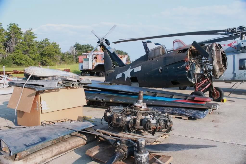

I've got nothing to do with it, I was just surfin' on Barnstormers and
there it was (there's a few pictures on the Barnstormers listing). Neat find....

If that's this aircraft's engine lying on the shop floor in the photo, it's interesting to note that the nose case is almost completely dissolved away, kinda like it was underwater for a long time...though the prop is straight. Any chance this could be an ex Lake Michigan bird?

I would naturally defer to Craig Q or other people who work on these things regularly, but to me, this DEFINITELY looks like a bird which was in the water a while... although I'm not sure it's a Lake Michigan recovery, because most of those seemed to carry an M## code.
Pics:
It's cool, and I'd surely love to own it, but that price seems a bit high to me considering how much you'd have to do to get the aircraft airworthy.

Hopefully some more information will be forthcoming (like a BuNo for example).
Are the Wildcat main gear (and tail) wheels made of magnesium? I'd think those
would have dissolved long ago if this aircraft had been submerged for decades.
Perhaps it was underwater and was recovered decades ago (?).
Interesting that the prop looks straight (as does most of the airframe). Usually,
when an aircraft enters the water at speed (even during a "perfect" ditching) there is
significant hydraulic damage to the airframe....

It certainly looks like 55404. It was in storage at P'cola last year when I looked at it with a customer who was in negotiations to purchase it. If it is 55404, then it was part of a trade deal and has clear title from NAVY, and it is a lake michigan recovery. Aircraft was resting in the silt on it's back (notice the grunge line on vertical stab, and across canopy/fuselage backbone), then also it certainly was not "in a barn" for 50 years, Davey Jones Locker perhaps, but not a barn. The wings were remarkably good shape, the prop was straight and the fuse was damaged, but not too bad. The worst thing about it was the deterioration of all the steel (notice the red-oxide applied by NAVY all over to prevent further decay). We planned on replacing all fittings and tube structure (engine mount and gear) with new steel.

99% sure it is 55404. Look at the cowl panel to the left of the engine, it looks like the stencil says 55404 which coresponds to how P'cola marked the parts while in storage.

FM-2 Bu55404 ditched Lake Michigan off training carrier
NMNA, NAS Pensacola FL: stored 93/04
_______________________________
Here are a few pictures of it at Pensacola.
