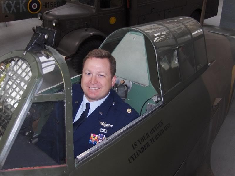

I'm looking at a calendar picture of Hurricane AE977 and that statement is stenciled on the fuselage under the cockpit in rather large letters. Is this a stencil that was used by the RAF during the war or is it unique to this bird? Thanks In Adavance.

I have seen that stenciling on the Vintage Wings of Canada Hurrican Mk IV.
Mike
Forgive the self-portrait.....G-HURI taken at Duxford in '07.

Hacker:
Your pix does not do you justice! :wink:

vlado wrote:
Hacker:
VL
Dare I even ask 'in what way'? :)

I guess I have to reply...........
You're a lot slimmer & taller in real life.
