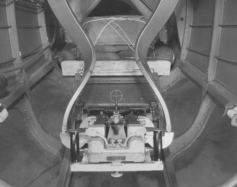

There was a twin 30 cal gun mount like what goes in the back of the SBD or SB2C or the bow turret of the PBY. They are all similar but actually different mounts. The one for the Ventura has a stud or bolt that goes into the hole pictured on the one side of your mount. The whole center casting and gun mount will pivot up and down and the twin gun mount traverses from side to side inside the casting.
Here is a shot showing the whole installation and a close up. In the closeup you can see the springs on either side that helps to balance the heavy gun mount to make it easier for the gunner.
There wasn't any swiveling armored glass in this mount. Not a lot of protection, just the ability to shoot back with very limited vision :shock:

I don't think the short 30 cal gun barrels would hit the ground on the PV-1 but I am not certain. I believe the springs are simply to balance the guns.
This balancing act can be seen on many different aircraft flexible gun installations. The weight of the guns and ammo in the feed chutes are pretty heavy and if the gunner had to lift this weight all of the time it would wear him out pretty quickly. The late B-17s had a large spring in the mount of the waist window to balance the load similar to your mount. The nose guns typically had cable or rope from the gun over pulleys to tension springs or bungees for balance. The B-25 waist even used sliding window regulators attached to the guns with cables.
Thank you!

Here is a shot of the outside of the ventral or tunnel gun in the PV-1. The primer can easily be attributed to the fact that the RCAF and British both used Venturas. In fact our PV-1 was with 115 BR out of Tofino thanks to information kindly provided by Anthony Jarvis.
