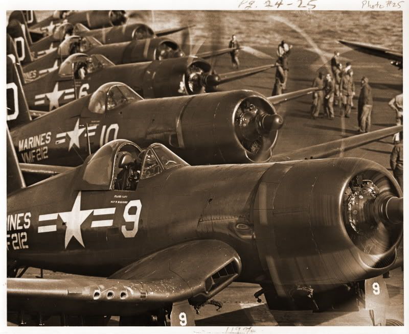

The F4U-4 did not use them..not sure about all -1D...now something some of you do not know, is that some of the -4 used early model front windscreen...!!![/b[b]] "Check Out #9"

Just in the photo above it looks like to me you can see the two different styles of -4 canopies, the earlier models with the old rounded canopy front piece, while on the Corsair behind it the front piece looks to be a flat front panel, which would be ubiquitous to the Corsairs through the end of the plane's production run. The General rule with Corsairs was: Birdcage canopy=dash 1 Corsair, two support bars= dash 1A Corsair, no support bars= dash 1D Corsair, Flat windscreen up front and no support bars= dash 4 Corsairs. This was, as illustrated above, not an absolute rule however, and there were variations here and there.

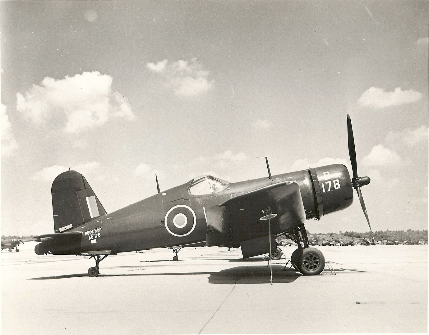

Goodyear Corsair KD 178 for the Royal Navy-
Photo dated July 8, 1944

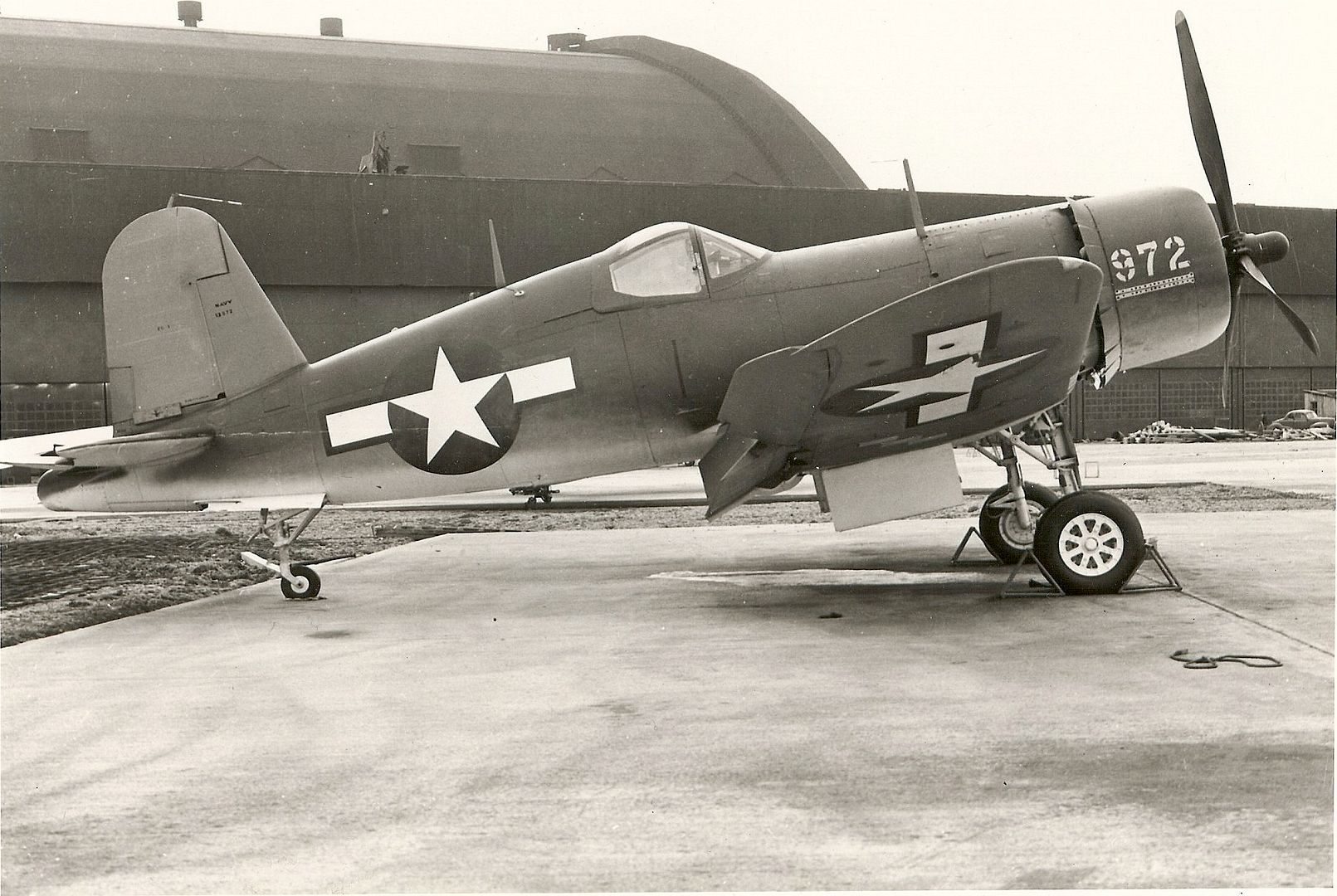

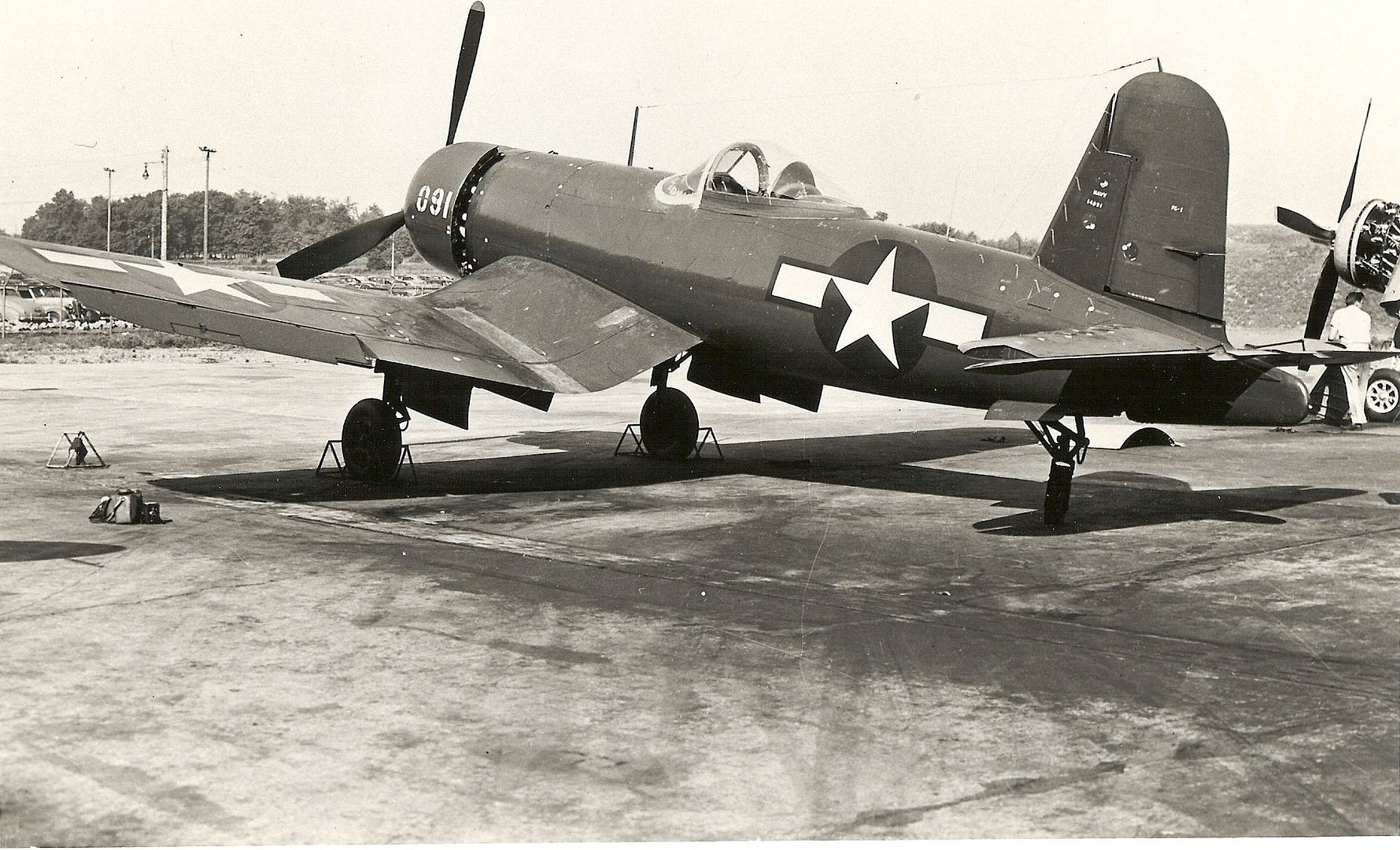

Goodyear FG-1 BU 13972 dated March 28, 1944-
A bit non standard-

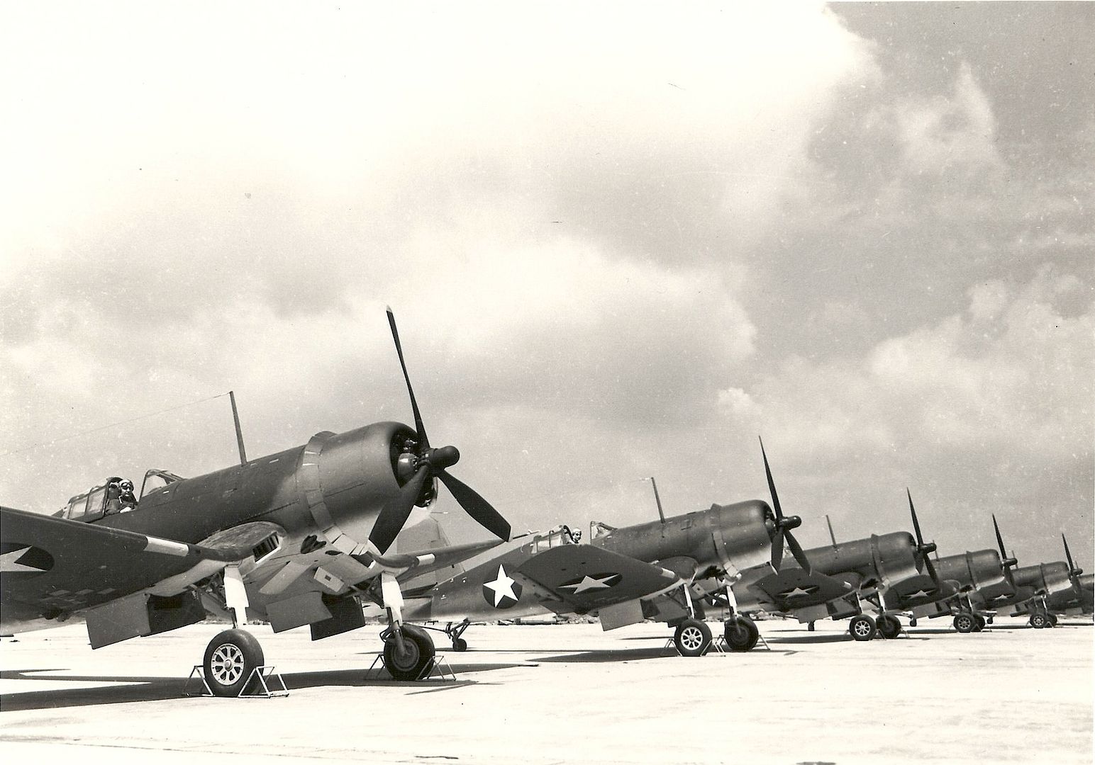

Goodyear FG-1A BU 14091 dated June 27, 1944 used for development of the bubble canopy for the F2G.
Photo info as printed on the backs of the pics.

Always wondered why they did'nt put the bubble canopied regular R-2800 powered Corsairs (Bottom photo, above) into service...great looking machines with superior all round vision....
Mark
That aircraft was a one off, I believe, to prove the concept of the bubble canopy. You are right though... it is a gorgeous looking machine! Putting these into production would have meant a radical change in the production line at a time when the war was winding to a close. I guess it just wasn't deemed necessary.
Richard
PostPosted: Fri Jul 16, 2010 2:28 pm
Posts: 5220
Im kind of curious to this one of kind design. If I was doing a Corsair data plate restoration I'd consider finishing it this way. Heck lets go for the gold and put a full second set of controls in too. 8)

Actually, a few -4 corsairs did use the earlier, re-inforced canopy. Certainly the WWII prototype -4's did, but you are right in that they changed to the fully blown style fairly early on in the -4's life. I do believe the Corsairs which saw active service in WWII only used the birdcage, or the re-inforced canopy. According to my Illustrated Parts Manual, dated 1 December, 1945, the birdcage canopy was replaced by the reinforced, blown canopy from Bu.17647 on upwards (no mention of when this happened on the British Corsairs). Interestingly, there is not one single reference to the fully blown canopy in my manual, so my guess is that they didn't appear on production aircraft until after WWII was over. I can't prove it of course, but the manual, you would expect, would be pretty much up to date. Does anyone have a -4 parts manual to go searching through?
Richard
PS. Mint... the -4's you showed in that gorgeous photo are all post 1947, since they have the bar in the insignia. Not sure this means much, except that it doesn't show WWII-era wartime -4's in service. Lovely photo though... wow! It also shows two styles of -4 canopies and windscreens, so it's really interesting from that perspective too!

As far as I know this is a Birdcage Canopy-
Goodyear Oct, 1943.
The twin bar canopy is basically the same shape as the full blown canopy on the FG-1 and F4U-1 series.
I believe in the -4 and later versions constantly changed the pilot position to give better visibility. I don't know how much the canopy changed or whether they raised it up higher.

The two main F4U-4 canopy versions are clearly demonstrated in Mint's photo. The aircraft in the foreground has pretty much the same windscreen and canopy setup as the late model F4U-1D... notice how the windscreen is a continuous curve, and the canopy is more or less a continuous curve in profile as well. The F4U-4's to its rear though have the late model F4U-4 arrangements with a flat forward windscreen (incorporating the armored glass) and a bowed out, and flatter profiled canopy. It's a really good illustration of both types. As I said earlier though... the very early -4's had the re-inforced canopy like he F4U-1A and early F4U-1D's.
Richard
