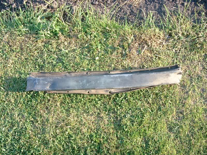

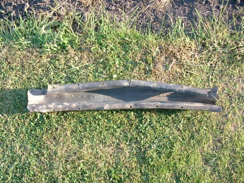

I pulled these larger bits from an ivy-covered hedgebottom recently, I've included a CD for scale:

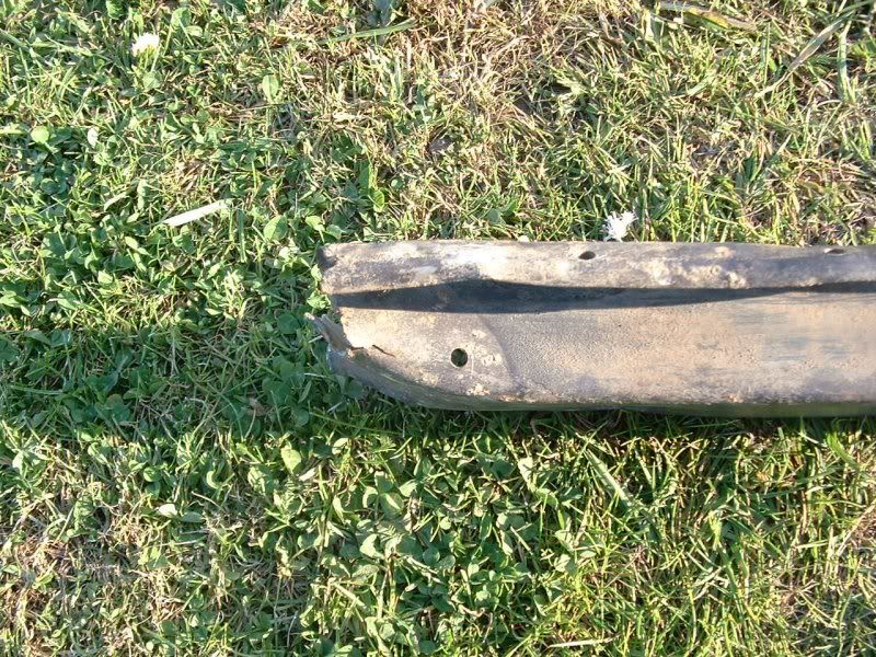

The thin strip on the right still bears it's Boeing part number...
...and this handwritten inscription:
If anyone can decipher either please let me know.

I've just realised the photo of the part number isn't all that clear.
The printing reads:
4J2 W
15-7500-11

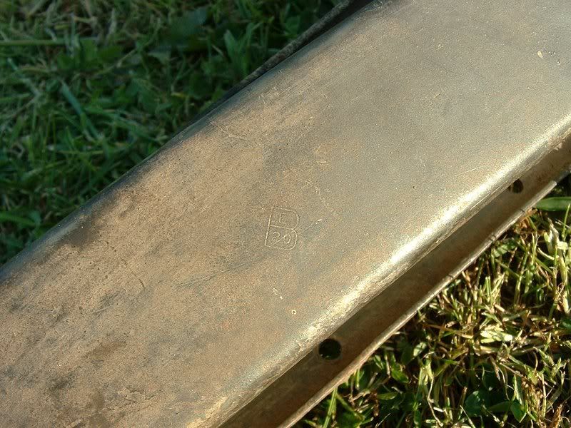

That photo of Chuckie's wing reminded me of another lump that I picked up a few yards from the first ones.
Looks very similar to the chunky "top-hat" section channel the corrugated panels attach to in your photo:
Just look at the sloppy paint finish on the inside!
Trace of the attachment bracket?
Boeing inspection stamp:
I wasn't expecting to see that, as '825 was a Block-1 Vega built B-17G.
The 401st had only flown two missions prior to her loss, indeed she was less than three months old, so I can't imagine how a Boeing-made channel ended up in a Vega B-17. :?

RAMC181 wrote: I wasn't expecting to see that, as '825 was a Block-1 Vega built B-17G.
My guess would be that the same sub-assembly maker made the parts for all Fortresses regardless of who would do the final assembly.
As far as the other part, I'd guess the handwriting is L(eft) H(and) ...notice both are in caps...then something else I can't read...perhaps Drab.

IIRC, the "hat channel" in your picture was located inside the lower wing skin, just forward of the ailerons, running fore and aft (but they may have been used in other locations, too).

15-7500 is not a good Boeing drawing number (I don't believe). 15-7600 is the drawing for the wing/tail de-icing system.
Re: B-17 wreckage from an English village hedgerow
Mon May 17, 2010 10:04 am
As can be seen from the photo, it could be a 5 or a 6.
Running with it being 15-7600-11, and looking at the E&M Manual, I wonder if it's one of the deicer boot fairing strips.
With it having only one line of holes, that would make sense.
All the best,
PB
Mon May 17, 2010 2:32 pm
Paul, I would say that is a 6. Compare it with the 5 in 75-, totally different shape. Your de-icer boot fairing sounds good!
Fri May 21, 2010 10:09 am
(ahem).... err, well spotted Dave, I was wondering when someone would notice that..... :oops:
So, 15-7600-11 it is then.

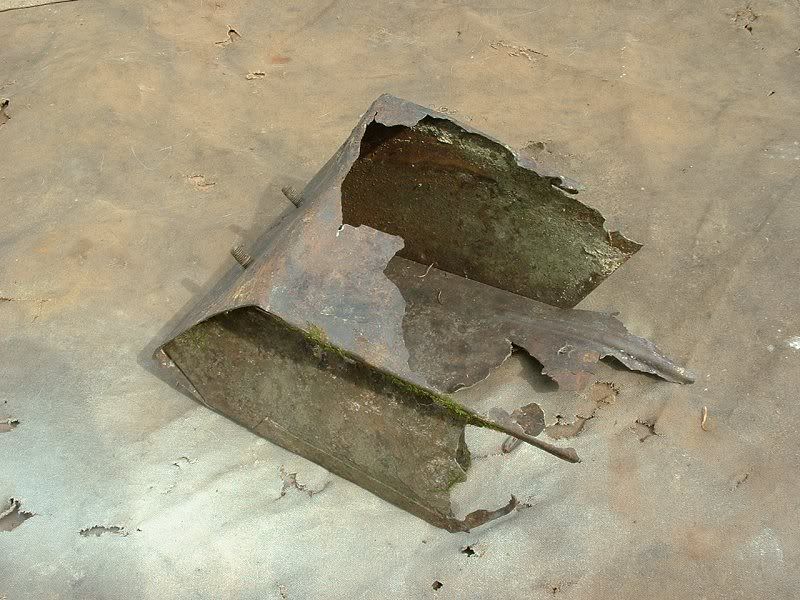

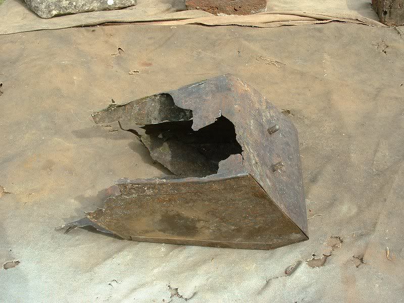

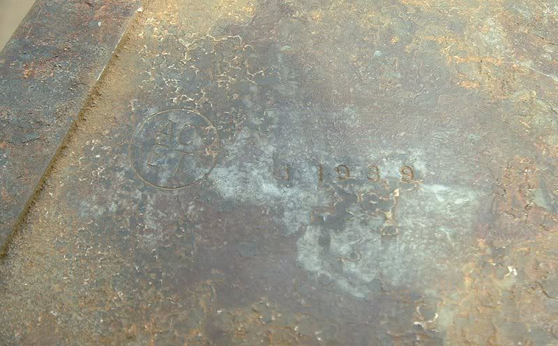

I was handed this by the farmer today, from elsewhere on the airfield but he reckoned it "looked a bit like the right sort of stuff you pick up".
The only markings visible:
AC over ET in the circular inspection mark, and 1 1939 adjacent.
Thu Jun 03, 2010 8:31 pm
It's been suggested to me that the AC over ET stamp may be an Emerson inspection mark.
Any thoughts guys?
Fri Jun 25, 2010 4:38 pm
Paul,
I was looking for an older post and came across this thread.
The boxier part marked AC/ET is for the air induction ducting from inside the wing.
I have seen those odd stacked washers inside TEXAS RAIDERS wing, and I still don't know what they are all about.
But that is certainly in keeping with the other wing re-inforcing corrugation and the de-icer bits.
