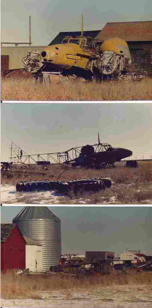

I am wondering if any of you Prairie or Western Canada WIXers know who ended up with this Anson?
I took this photo in 1988 near Elkhorn Manitoba (I think according to my notes) and wondered if it is still there or did it end up in a museum somewhere? Also who owned it then?
The third photo a Cornell canopy can be seen over the items just to the right of the silo at the same location.
Sorry about the quality of the scan, I haven't figured out my new scanner yet to copy all of my old photos.
Mike

If I remember right I think this is one of the ones that ended up at the Nanton Lancaster Museum...Now the Bomber Command Museum of Canada.
I do believe they are the current worlld centre of recovered Ansons...seems they made the effort to gather the loose ones on the Prairies.
Check with the /Curator Dave Birrel (Splng)
his e mail is on their website http://www.lancastermuseum.ca/
Tom

Bomb evans is Curator not Dave unless somethings changed? I would think this one might have been recovered by BCATP Museum in Brandon. A bit far for Nanton??
Peter

Thanks guys...I was surprised how much of it was there intact.
The wings were long but gone. And who knows where the engines were.
We have some flight controls and such in Hamilton from one that we brought pieces of back from a farm west of London Ontario many years ago.
Would love to see one completed to fly.
Mike

100% confirmed it was not recovered by Nanton. They only recovered ansons in Alberta. There is a slight chance it was recovered by BCATP Museum in Brandon or Moose Jaw? Any further info on its location??
Peter

I'm pretty sure Bob Diemert had the remains of an Anson at his place in Carman, Manitoba, in the mid-70's. I recall seeing it there several times.
Walt

Well as I said, this was near Elkhorn around 1988 and i think it was just off the Trans Canada Hwy. I should have been more nosy and went door knocking back then. Is there any wings stored that have the making of a pattern out there to complete a flyer?
Does Nanton have a complete airframe with a wing?
Mike
