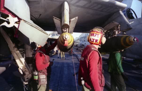

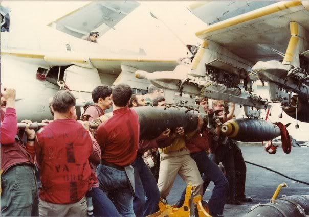

First ya start with a real bomber :idea: 8)
Then load Mk-84s on it the old fashioned way ie hernia bar :?

Sweet Dawg...SWEET!
In the grand scheme of things, when do those red fuse tags come out?
Before the plane gets positioned on the Cat?
Happy New Year Jack
PostPosted: Thu Jan 21, 2010 10:44 pm
The pins get pulled before taxi. Ashore there is a arm/dearm area well clear of the ramp.
The pins for the MERS or whatever the loadout were pulled along with the
centerline are pulled and displayed to the pilot who gives you a thumps up and then placed in
the well for the left boarding ladder which is then closed. Also you have to arm the MAK-79s on
the MER. God I loved that sh*t!!!
as six stores attached to the ejector units (i.e. BRU-20 Ser. or MAK-79). Each ejector unit has four adjustable sway braces and two mechanically locking suspension hooks spaced 14 inches apart. Bombs are suspended and attached to the Multiple Ejector Rack by two suspension lugs 14 inches apart [except the Mk 84 which had lugs 30 inches apart]. Release was achieved by firing a charge that actuated a piston that forced the bomb off the MER. Each ejector unit is equipped with a safety stop lever located on the rear sway brace assembly which, when rotated to the locked position, prevents accidental stores release.

just try doing this with your hands in your pockets!!!!
S.
PostPosted: Fri Jan 22, 2010 1:27 pm
It can be done!

That's the Navy way, all right.
I've had to write loading instructions for certain ordnance in the past, and go out to the Fleet for "verification," which is where we have the youngest and least experienced sailors (preferably) do everything the manual tells them to do, as long as it doesn't break the equipment.
I'd write the procedure to use the appropriate hoisting gear (sort of like a chainsaw-motor-driven winch), and invariably, the first time that thing went on the pylon, it would be via the "hernia bar" and whoever could crowd around the item in question (which weighed, generally, more than 700 pounds).
After it was loaded the first time, and the hooks locked, and the electrical harness connected, _then_ we could take it off again, and load it up using the hoist. With visible distaste from our squiddly brethren, who avoid such niceties in normal life.

The 2 hoists were the aero-14C and the HLU-196 which was powered by a small engine.
We never preloaded weapons onto the MERS and with spaced limitations on the boat we never
used anything but hernia bars for the dumb bombs. They were used for smart bombs like the
Skipper and CBUs. I prefered the bars has it was quicker and with less fuss and muss. Mk-82
had 2 men on each bar, MK-83s had 3 on each and the Mk-84 had 4 on each bar plus 2+ on the
bomb itself. BTW The checklist was GOD! In P-3s we used the 47 loader and the 14-C almost exclusively.
