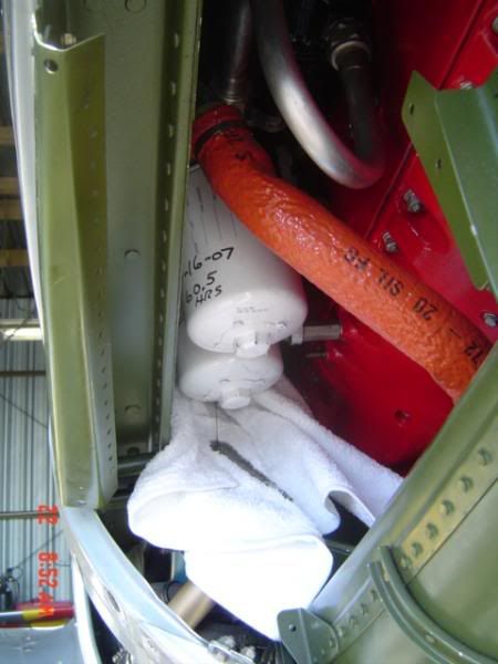

Next and of vital importance is the kit that Jack Hovey machined that adds Champion paper cartridge filters to the oil system.The Merlin pumps so much oil that you need two flters. These are very fine and really filter down to microns. Cost used to be about $2500 per kit an d worth every penny. So now there are 2 fliters to replace and 3 to clean.

Bill Greenwood wrote:Next and of vital importance is the kit that Jack Hovey machined that adds Champion paper cartridge filters to the oil system.The Merlin pumps so much oil that you need two flters. These are very fine and really filter down to microns. Cost used to be about $2500 per kit an d worth every penny.
I'm pretty sure that adaptor that holds the two filters is a Caterpillar part, it sure as heck looks like it.
Custom made by Hovey products but sold through Stallion 51 IIRC. Comes with all the paperwork to submit a 337 for a field approval if used on a limited cat A/C.

51fixer wrote:Custom made by Hovey products but sold through Stallion 51 IIRC. Comes with all the paperwork to submit a 337 for a field approval if used on a limited cat A/C.
Roush is using modern filters that have a re-cleanable screen element inside a housing that screw on the same as the Champion filters.
Rich
Okee doke, there isn't really much difference you could design into the look of something that holds 2 oil filters, I guess they all look pretty much the same. (I have one on my Dually) :)

The kit may have been developed together by Jack Hovey, Hovey Machine Products, with the Lauderbacks, Stallion 51. They probably sell to the 51 guys, we got our kit from Jack.
There is more to the kit than just the one adapter, there are hoses, and I assume some sort of one way valve to keep the flow correct. Above all it needs to be safe. Ray had to do some adapting to use this on the Spitfire as it is slighlty different than the 51.

One of the Mustangs I work on has this set up, which I think may be a Hovey deal:

I recently put an Airwolf kit on a T-6. Looks a bit nicer than the Skytractor unit but both are good products. Specifies a Fram Racing or equivalent filter so that may be the wix filter mentioned.
As good as the modern twin spin on filter set up for a Merlin is I personally don't believe it is much better, if at all, than the original Packard Cuno. Many of the RR built Merlins as well as all the Griffons don't have a filter, just screens which really only catch chunks. They are not meant to filter, just indicate something bad is already happening. On the Griffon they did put a filter on the inlet oil to the Prop Gov so you will maintain prop control as long as possible. Even the Packard Cuno, as well as the Hovey filter, are in the oil out line of the Pressure Oil Pump as it heads into the engine. Nothing is filtered as it leaves the engine or before it goes through the oil pump entering the engine.
