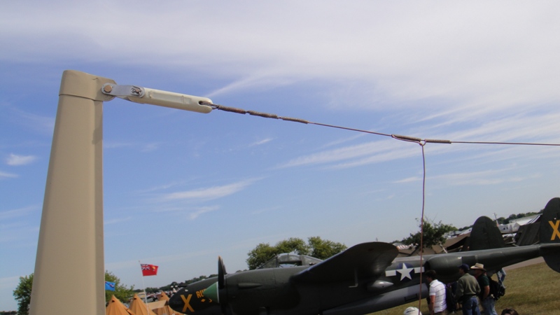

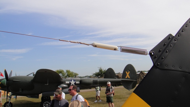

Here are some shots of a P-40 at OSH last time that has the correct type of antenna termination. I have not seen any specifications that called for soldering over the wraps shown here so I wonder if it may have been a Curtis requirement.
I have several different manufacturers drawings for these types of terminations, lead ins and T's and they do not mention soldering. I also have several original examples in our collection that also do not show soldering.
The lead in on this P-40 is also different than the ones I am familiar with so once again I wonder if it is a Curtis thing. I also question the spring simply being hooked as it is. The normal springs used in antennas in WWII were a lot stronger and were not open type. They were usually secured with shackles, clevis' and clevis pins.

I do have a Vultee drawing of how to do the wraps. The drawing says "do not solder" also. Got some copper coated steel wire thanks to BDK's links and all I need is a shackle like the photo above, it has a 1/2" opening for the insulator - do you have any Taigh?
