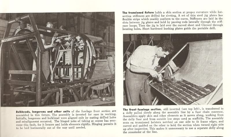

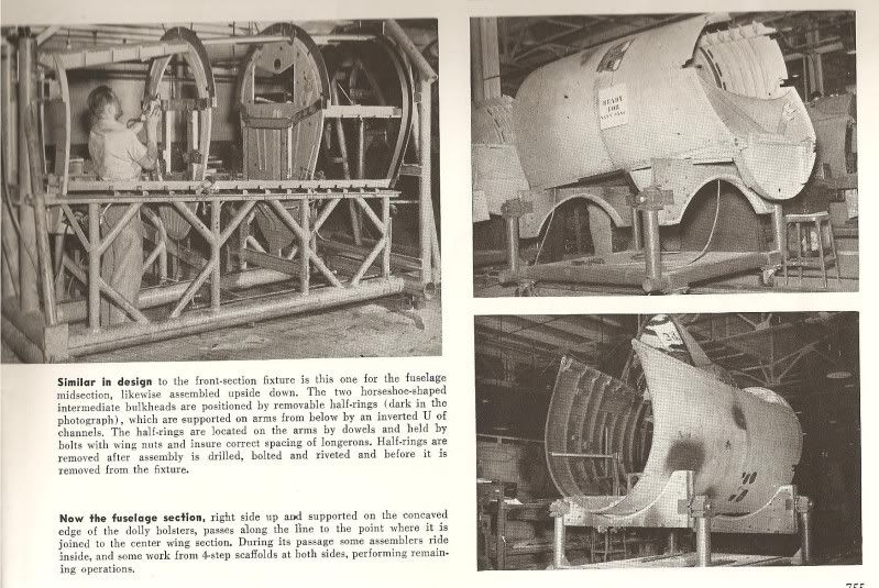

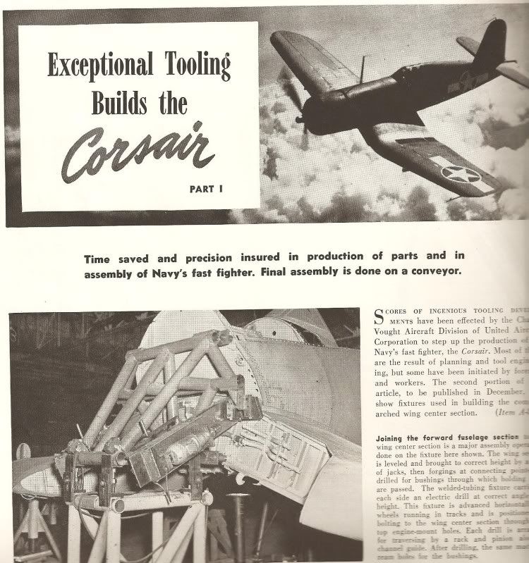

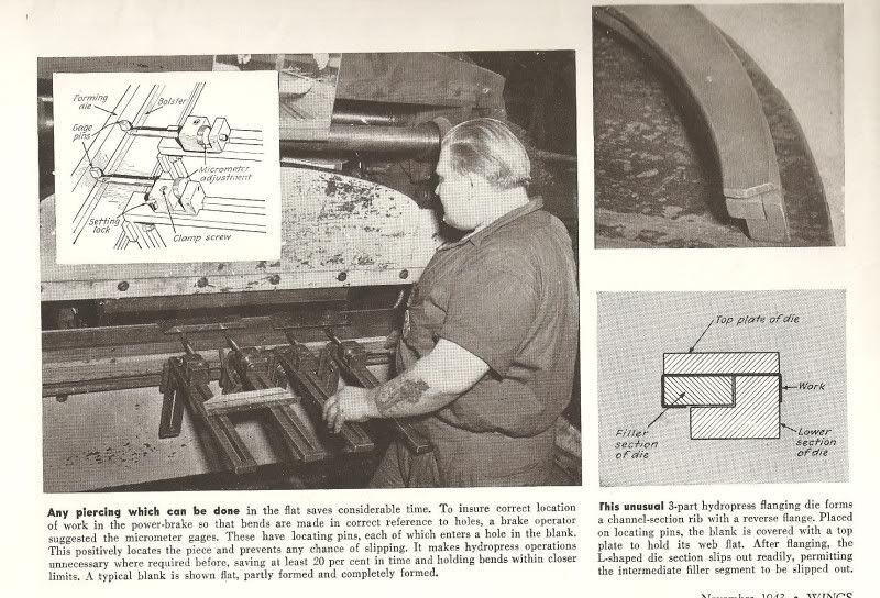

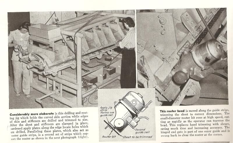

As someone who is also using 3D modeling and reverse engineering technology, I am very impressed with this effort. In my case of building a P-35A replica using modern technology, I was always trying to find "factory" pictures of how the aircraft was built originally. As a result I have accumulated data on a variety of aircraft in my search. Here are some scans from World War II magazine on the production of the Corsair. I hope the pictures may help you with your effort.

WOWWWW!!! These are absoultely fascinating images/details. Which magazine (and issue) did they come from, and do you have any more? I have seen very few detailed images of corsair manufacture. Usually, just the production line shots, which show the bigger picture. I do have a few shots of corsair main spar manufacture somewhere. I will have to dig them up when I get home in a week or so. Please keep posting though... these are fantastic!

I am glad you liked them. They are from the November 1943 issue of "Wings" magazine. Since this was "part 1" of the series, I am looking through my collection to see if I can find "part 2".
