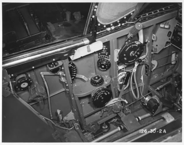

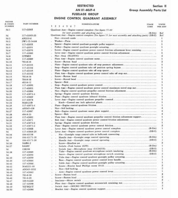

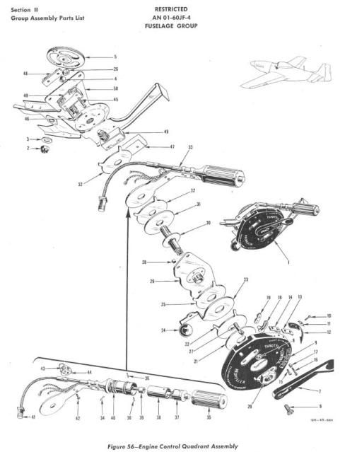

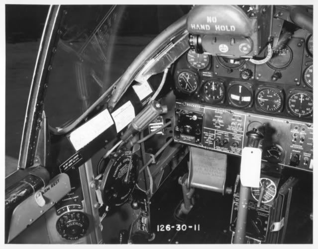

Hi all,
part number 117-43005 is the quadrant asy for the P-51H.
Cheers
Manukun
PostPosted: Fri Sep 25, 2009 3:19 am
Joined: Wed Apr 30, 2008 7:20 am
Posts: 2
Location: France
2 pictures from the original P-51H cockpit (source Swiss Mustangs from P51sig) :
Manukun
