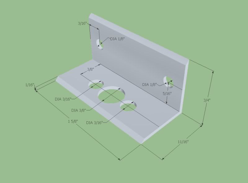

Here's a quick-and-nasty CAD image of the piece with dimensions that may be of use:
All the best,
Paul

The holes on either side of the 3/8 hole should be either 3/32 or 1/8 and would be countersunk. A nutplate would have used 3/32 and a dzus spring would have been 1/8. There is a possibility of a large nutplate using 1/8 holes. The countersinking is done to set the rivet flush with the surface so nothing protrudes.
The distance between the rivet centerlines will help determine whether its a nutplate or a dzuz spring.

Thanks chaps,
I'll get the steel rule onto the thing in the morning to get more accurate measurements.
All the rivets are/were rusted, so iron/steel, if that gives any clues.

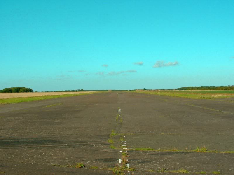

Here's some "Then and Now" shots I took at Deenethorpe for the Association's forum:
Radio Training building:
Crew room:
Chute Shop:
Sub Depot area:
No Forts over Deenethorpe today:
Just birds of prey and the occasional light plane using the old main runway:
