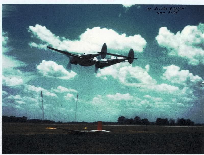

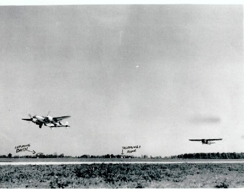

Gen. Cardenas was kind enough to allow me to share the two photos he sent to me. In one, you can clearly see that he is towing a CG-4A. In the other, there is a much smaller glider sitting near the point where he is making the snatch, so maybe that's from a different experiment. Anyway, this is what he relayed to me:
"Have attached a couple of pictures that are definitely not known. My boss General Fred R, Dent was in charge of glider development for WWII. WE established a special base for that in Wilmington Ohio at Clinton County airport. I was in charge of developing the best tow plane for the invasion Gliders. I proved that the P-38 was the living best. Then one day a couple of civilians in grey flannel suits established a requirement to snatch a glider or human from the ground with minimum equipment required.
Attached are pictures of me snatching a CG-4A with a P-38 and the towing it all the way to a base in Florida. Have no idea what it was for and did not ask."

Both above photos of Bob Cardenas' were made at Clinton County Army Air Field. The B-W is a regular tow, off the ground, of a CG-4A glider. The color image is a P-38 "snatching" a tow target. This could be done because the tow target was very light weight -- likely less than 100 lb.
Bob Cardenas could probably expound on the P-38 with the collapsed nose wheel and bent tail booms. In my research, I have not found a written documentation speaking of the accident. But, early on, Bob was about the only power pilot that pulled a CG-4A glider with the P-38. It would have been him or Chet Decker.
The P-38 take-off was so fast the CG-4A (or CG-15A) would be off the ground flying in a very short distance. The glider pilot had to fly the glider close to the ground until the P-38 was off the ground with plenty of clearance. If the GP pulled up too high the P-38 would be hung by its tail putting the nose on the runway. This is likely what happened to cause the nose wheel to collapse and break the tail and it was probably lucky that both planes got stopped and did not pile into each other a few feet off the ground.
I would post a picture of the two P-38 tow releases but don't know how. There was a release built into the horizontal stabilizer just outside of each vertical stabilizer. A yolk (cable) was attached to the releases and the glider tow line attached to a device that slid on that cable (yolk). A P-38 towing more than one CG-4A or larger glider is doubtful. The C-54 was the only tug that coudl successfully tow three loaded CG-4A gliders.
A snatch of a CG-4A by the P-38 is unlikely because the P-38 could not be equipped with the required snatching winch. Along with the elasticity of the nylon tow line, the winch was the real secret that made the snatch possible (explained in other threads on this site).
