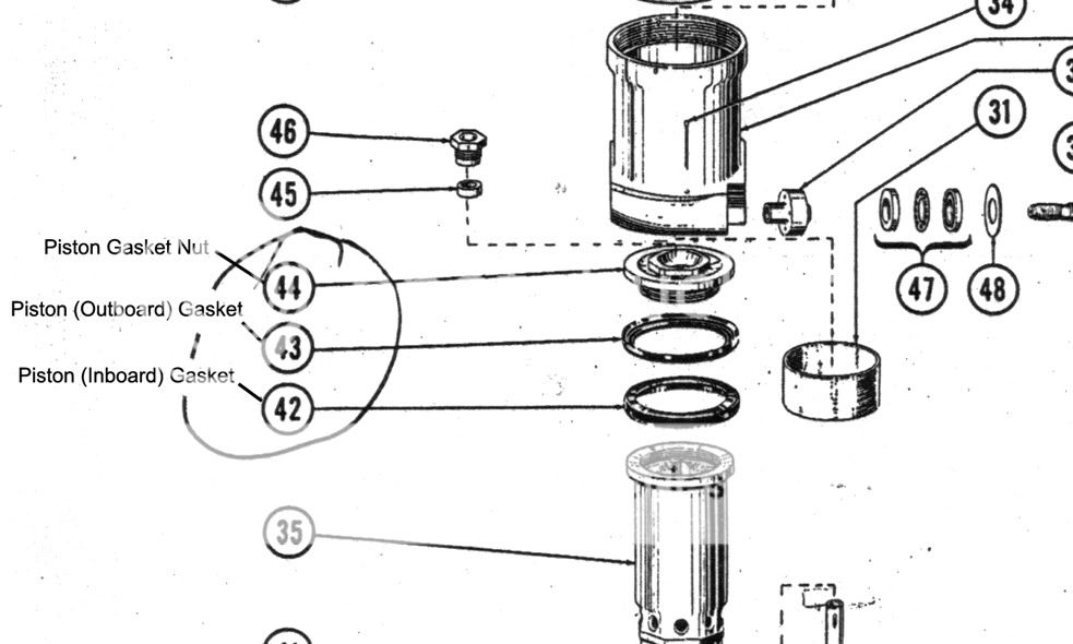

I paid the restoration guys a visit in Tillsonburg today and they're urgently looking for a couple parts for our Yale engine/prop to allow it to fly.
More on our Yale here.
The R-975 was rebuilt in a shop in Florida which has since closed down (can't remember the name), and the parts were never put back on the engine when it was reassembled there.
The parts in question are the Piston Gasket Nut, Piston (Outboard) Gasket, and Piston (Inboard) Gasket that go on the end of the crankshaft inside the prop.
Here's a diagram with the needed parts circled:
And a close up:
We have a few people calling contacts all over Canada and the US looking for these parts. Hopefully someone here knows the location of some.
These parts are basically the only thing standing in the way of Yale 3399 returning to the skies.
Please contact me if you have access to these parts, or know someone who does, and I will let the restoration boys know.

You should PM WIXer Eric Downing. he has a Yale here in St. Louis and I think he just had his prop overhauled. More importantly, are you saying that the prop shop or engine shop "forgot" to put those parts back into the 2D30 hub? Is it the same shop that did the engine overhaul? If so, I'd be a bit nervous about that engine. :shock:

What dash number 975?
You are showing a crank shaft breathing 2D30. If it truly is a crank breather with the long oil pipe (item #36) as shown in your illustration......good luck. Wright is the ONLY manufacturer of #30 0r #20 spline engines to do this. That takes a special hub with breather holes on aft edge and the piston needs a hole thru it and a seal/packing nut (items #45 & 46). Pretty special. I wouldn't climb on the OH's back, possibly the engine OH was upgrading the crank to eliminate the long oil pipe and crank breathing and thus those special hub parts omitted.
look at your 975 and see if that long breather pipe is there...it will be beyond the crank end by a good 2+". Or are you looking for the parts for a crankcase breathing 2D30 as shown on page 5, Figure 3 of your 110D manual?

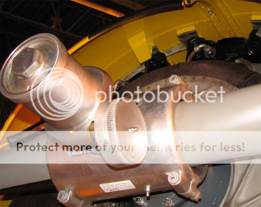

Hmmmm....
No nose case governor. Do you have a rear mount governor on the three way drive? Or are you running a two speed prop? Those counter weights look like the light weight aluminum ones for the two speed. If it is a two speed, do you have the auxilliary oil feed line entering the nose case between #'s8 and 9?

Shane,
If you can give me the specific Hamilton Standard part numbers of the (3) items that you need, I'm sure that I can help. I have a very large inventory of vintage Ham/Std parts.

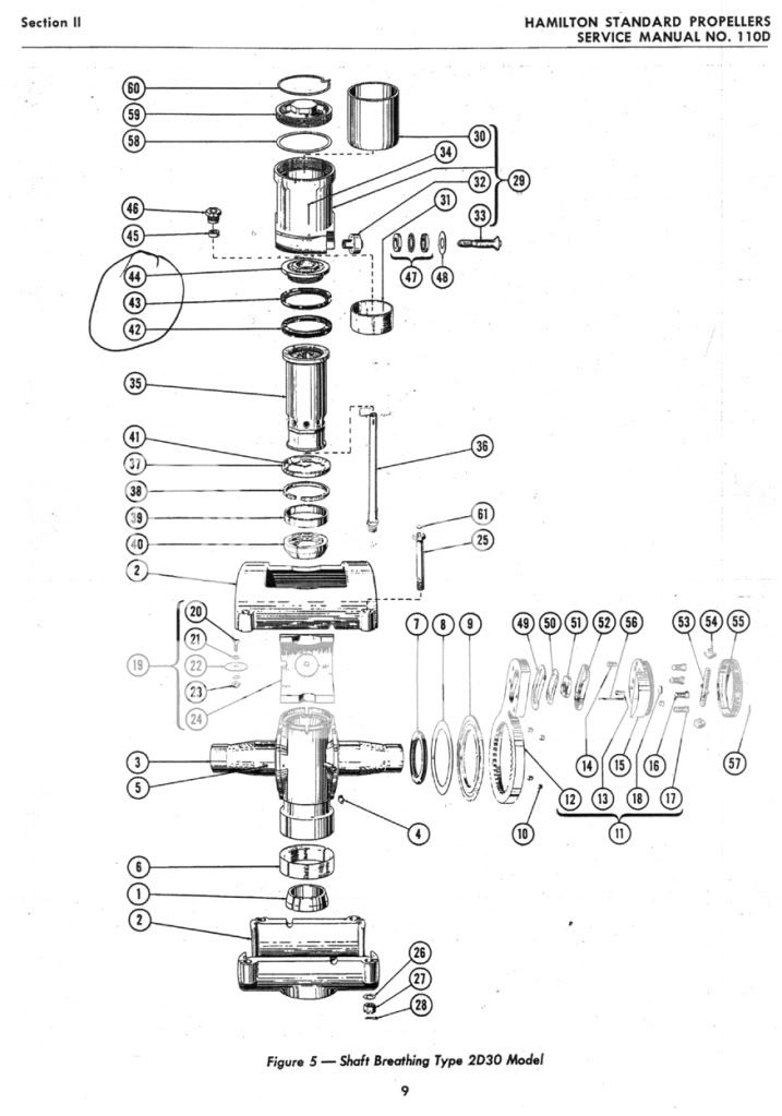

Just got back from the hangar with another task. AFAIK, we have sourced the seals we were looking for, but after Rick (our AME) had a look at the crankshaft of Yale 3372 at Dunnville, there's some more parts we are missing.
Hopefully someone here has either a Wright R-975E Whirlwind Parts Manual or Overhaul Manual so we can find out the specific parts numbers, or better yet, if someone even has the specific parts or know where some are!
All we have is the repair manual, which only refers to the parts by name, not number.
These parts should have been put back in when the engine was reassembled by Dumont's in Florida, but with the delays with Transport Canada, (and the fact we're used to working on P&W Wasps) the ommision of the parts wasn't noticed until now.
The parts we have in the crankshaft I have highlighted in blue. The parts we are looking for are in red. AFAIK we have the oil tube spacer (?) in yellow, but we aren't 100% sure if it's all the parts we need.
This is the page out of the repair manual with the paragraphs pertaining to the parts we need highlighted.

Just a quick update here folks. Upon talking to someone who helped out with the engine overhaul in Florida, we found out that we weren't missing any engine parts at all :lol:
Goes to show how little we know about Wrights :D
Anyway, it turns out that when the engine was overhauled, someone from CHAA (not sure who) told the rebuilder to 'put it back to original' which meant it was left as a crank shaft breathing engine (just as Wheels up said in his first reply). However, the prop that is on it was for a solid shaft engine. :roll: I guess that would explain why it wouldn't stay in fine pitch...
So, off came the prop, and we contacted Hope Aero. They looked around and they do have the correct crank shaft breathing prop parts, and they are geting plated right now.
The prop should be back by the end of this week or early next week. 8)
After it's reinstalled, engine testing will commence, followed by taxi tests, and then flight tests! If all goes well, the C of A should be issued later this year.
