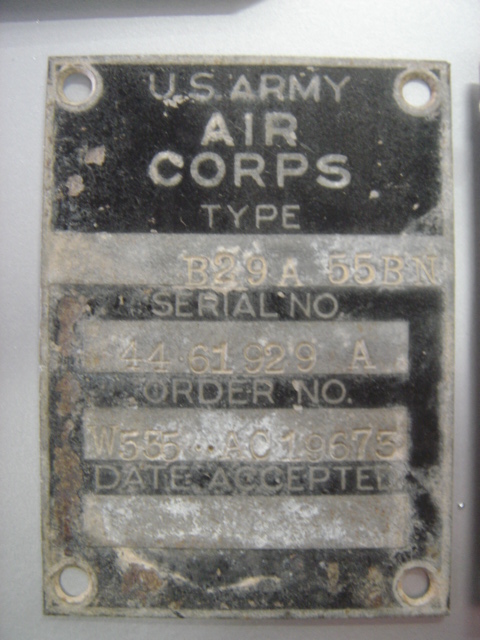

I was told what the A was for 30 years ago when I picked up this data plate from the B-29 in Soccoro, NM. but sadly I have forgotten what it was. More sad was the fact that she was scrapped in Socorro.

Thats the best Ive heard so far. The problem i have it that my dataplate is original, and I have no A stamped on it, but the FAA has had it in their database since 1967. The last dataplate added or moded was the 1954 Hayes Modification to a VB-25N.
So I have no reason for there to be an A on the end of the serial number, no paperwork explaining why, and my dataplate has not got it on their. So reason would say, the A needs to be off the registration, correct? The registration matches the dataplate, not the other way around?
Unless their is some "Secret" document stating that certain airframes need to have an a?
