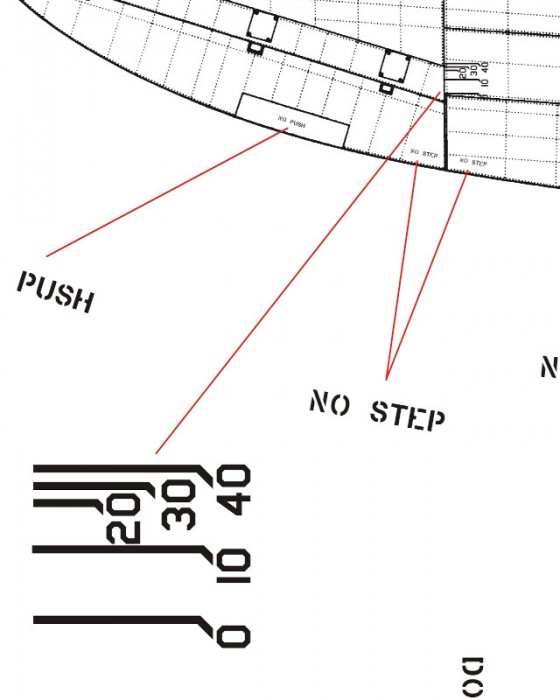

What is the purpose of the white lines on the leading edge of the wing near the guns?
(Source: Preflight Study Manual for Civil Air Patrol Cadets (Headquarters AAF, Office of Flying Safety, n.d.) 3-7.)
The explanations I have come up with or heard so far is that they are either for boresighting the guns, measuring wind drift angle, or bomb aiming.

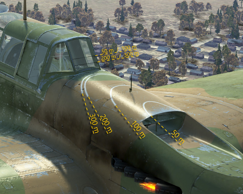

...the Il-2 has level bombing lines painted on the engine cowling...
(Source: IL2Sturmovik.com)

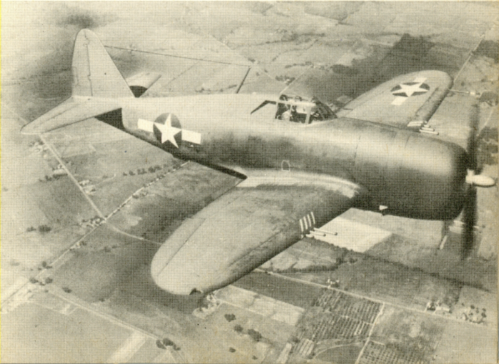

Some P-47s apparently also had flap angle lines painted on the trailing edge of the wing, so maybe that's where the idea came from.
(Source: RCUniverse.com)
EDIT (22-04-05): It seems that the above picture may have been taken for use as a recognition slide, as a different picture of what appears to be the same P-47 can be found in a set digitized by the State Archives of North Carolina.

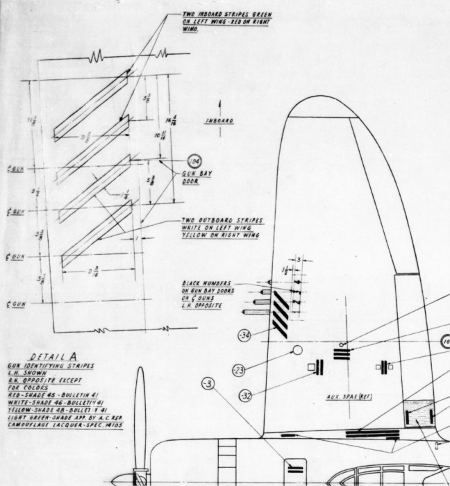

these lines are for guns identification, they were on P47B number 7 up to 47 only. colors were white, yellow, red & green in add
"no step" on trailing edge and "no push" on trim tab are only on warbird, not on WW2 airplane
Wow, that was a quick answer! Thanks!

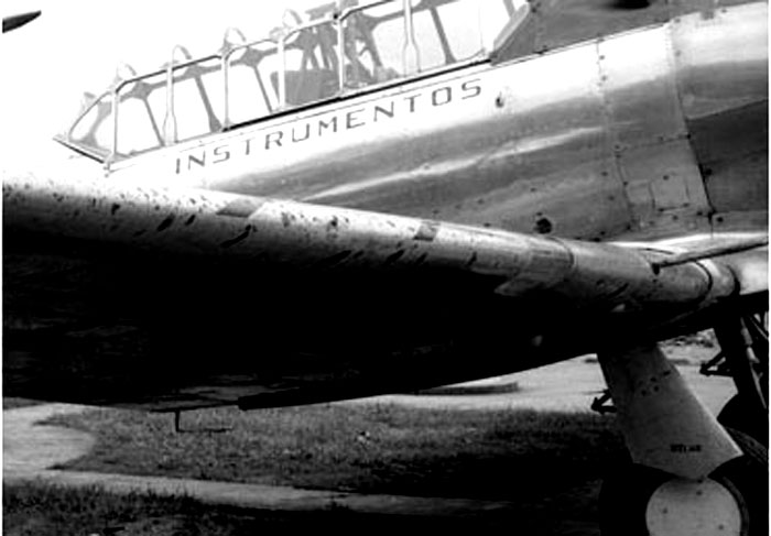

I have a T-6 aileron tab that is stenciled with the Spanish equivalent of "No Push." While it may not have come from the North American Aviation (NAA) factory that way, it was clearly applied for military service. Or, it could have been stenciled in Spanish by NAA under a spare parts order.
BDK,
T-6 and some of their NAA predecessors, saw military and civilian service in most -if not, all- of Latin America, including Cuba, the Republica Dominicana, and Haiti and Brazil.
They also served in large numbers and were extensively used in combat in Norrh Africa, by the Spanish AF (Ejército del Aire)
This would help explain the Spanish lettering you mentioned.

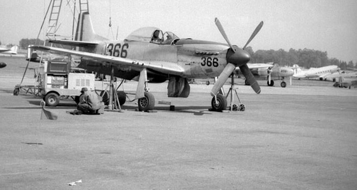

Two cropped photos, from my collection, via the Guatemalan Air Force files.
The diagonal markings are seen clearly on the T-6 (no wing guns) and on the P-51D.
The AT-6D suffered damage from the explosion of a bomb released at a low altitude.
Saludos,
Tulio

"NO AGARRARSE"
The handy online translator says something approaching, "Don't cling here"!
