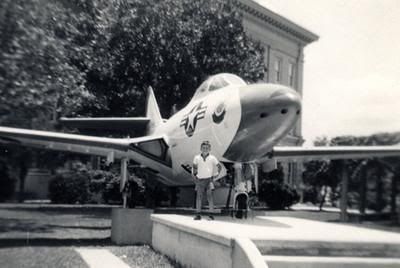

Also looking for information on the one near the Beeville TX courthouse. It was replaced or augmented by A4 142717 at some point. All I have found is this very intriguing picture.

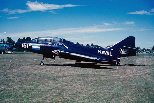

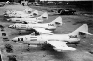

There are only two static F9F's in Argentina that I know of...are there any more?
127xxx 3A-118 Argentina outside display El Tigre c/n 0453
127xxx 3A-111 Argentina outside display Punta Indio c/n 0452
Also this one....whats its story?

Joe,
There are three in Argentina. The other is 0425/3-A-113, which is at the Museo de la Aviación Naval (MUAN) at Bahía Blanca/BAN Comandante Espora.
Andy Marden

Discovered that there were a couple of survivors in the Panther ranks that I would like to account for. Also wondering if there is a USN Bu# tie up for the planes....
c/n 417 was damaged during the "coup" of April 1963 and was scrapped...but the fuselage went to the Naval Aviation School in 1969...does this one survive?
c/n 421 was displayed at the Puerto Belgrano Naval base by 1971...then?
c/n 425 Naval Aviation Museum...thank you for this one, is it inside?
plus the two Known on pylons...450 and 453
