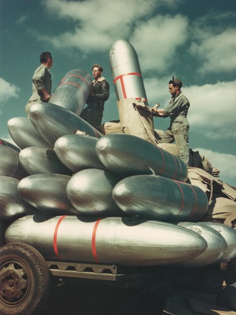

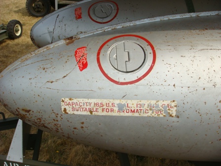

I think the paper tanks were doped silver but I think the steel tanks were painted with 'aluminized' clear lacquer or enamel. At least all of the AAF drops I have seen and owned had evidence of aluminum paint and rarely any primer underneath.
Here is a great USAF shot of 108 gallon paper drops on a bomb trailer
Here is a shot of a steel tank with the original finish and a water transfer decals

Thanks for the correction, Taigh. Neat photos.
