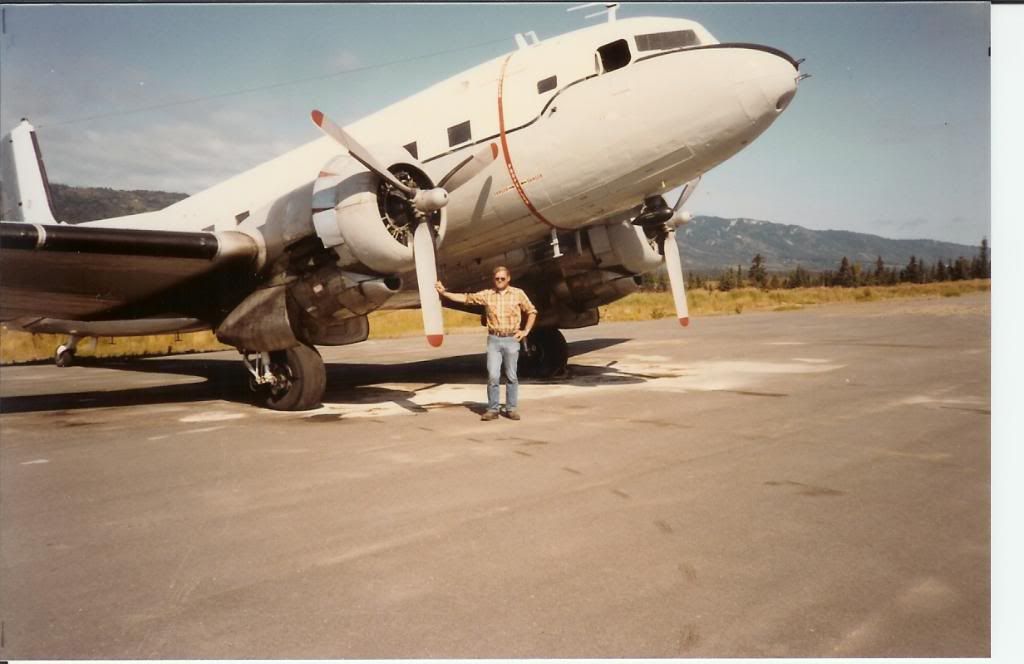

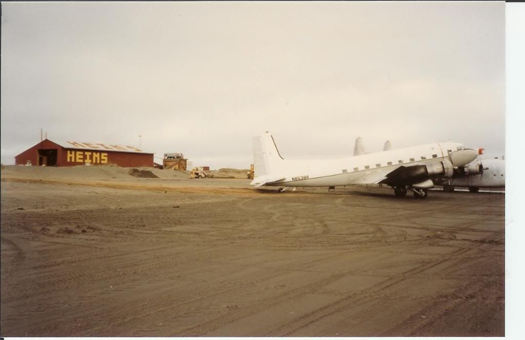

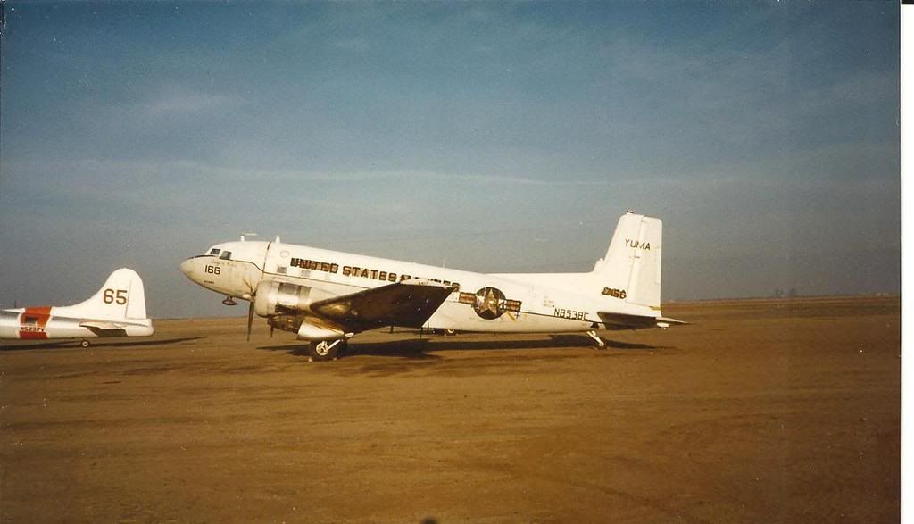

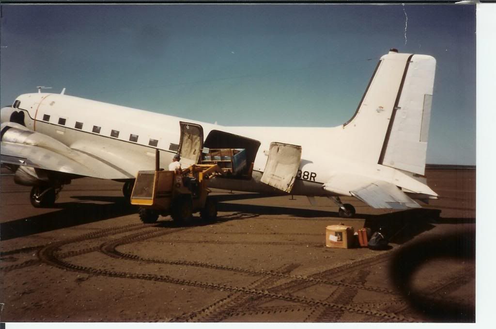

I flew a C-117D/R4D-8 on the Alaska Fish Haul in 1981.The engines on that airplane (and the other two that TBM got in a trade) were Wright R-1820-80B's.The only difference between the -80 and the -80B was that the -80B had a high capacity oil pump.Someone said that it was the same pump that the T-28C's used to assure full oil flow during catapult launches.These were low altitude high engines with high tension ignition which were rated at 1475 hp on 100/130 and were never rated higher with 115/145.They had pretty alarming power settings to someone with a lot of B-17 time.We used 54 1/2 " and 2700 rpm for take-off.We used METO power for climb.which was close to B-17 max power at 45" and 2500 rpm.There was a large rpm band that was placarded against running continuously due to a prop harmonic vibration problem.We weren't allowed to run between 2150-2450 rpm for any length of time.That eliminated the B-17 climb power of 38" and 2300 rpm and some of the higher cruise rpm's.As I mentioned,these were low altitude engines and we'd be at full throttle in climb by about 3000 feet as we could no longer maintain 45" of manifold pressure.The prop vibration was really there if you ran right at 2150 rpm.It always felt to me like we were losing a cylinder.There was no vibration problem at 2500 rpm.
This was taken at Homer,AK. in August 1981 when I was about 100 years younger.
These were taken on Egegik Beach southwest of King Salmon where we loaded freshly caught fish.

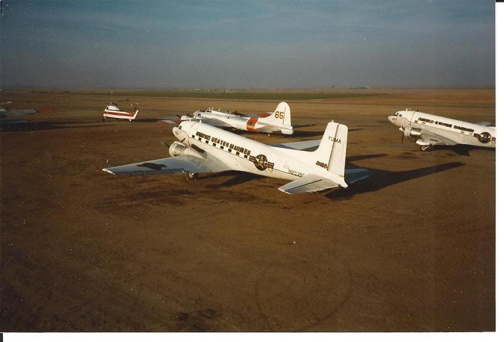

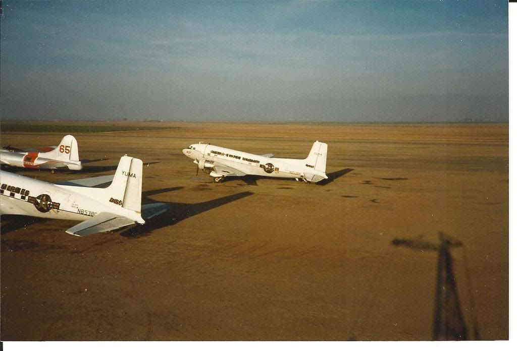

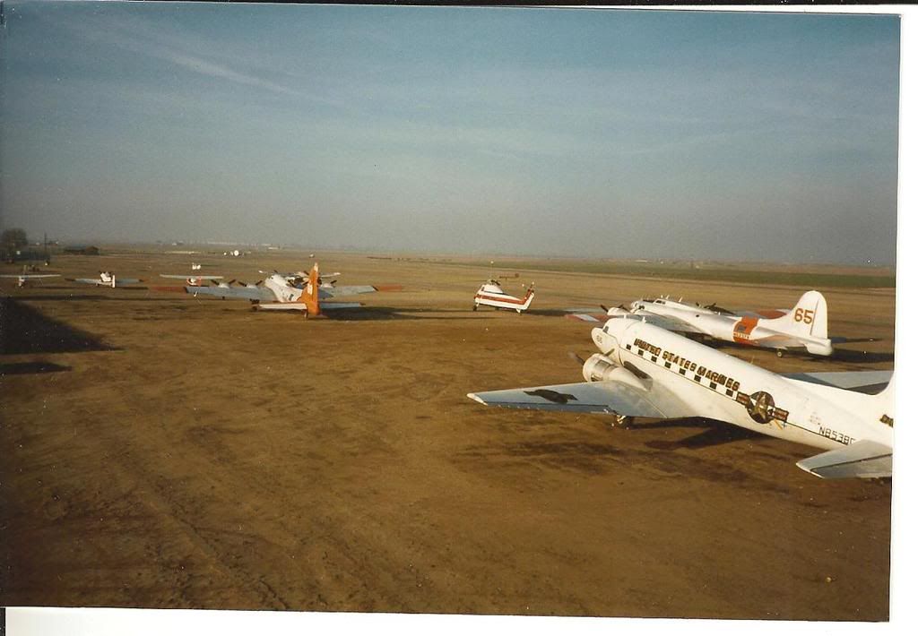

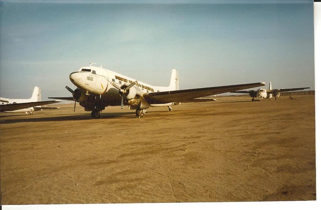

Here are a few pictures of TBM's C-117's at Sequoia Field
These were taken when TBM was trying to figure out if they could make the airplane into an air tanker.You can see an old F7F retardant tank under the belly on a bomb cart.They were trying to figure out what would be covered by a tank installation.
One of these days I need to scan the rest of my Fish Haul pictures,among others.
