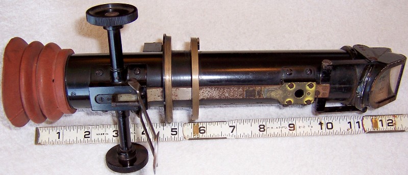

A gentleman sent me these photos of a device he has had for some time. He would like to know what it is.

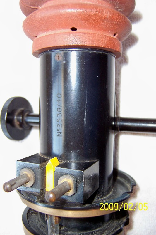

It looks like a drift sight to me that is missing the base and/or recorder.
The serial number looks like classic Air Ministry to me with a 1940 date at the end.
Do you have any idea exactly what it might be? Inquiring minds want to know...
Thank you!
Taigh Ramey

Looks like a RAF Tail drift sight to me?

PostPosted: Fri Feb 06, 2009 9:46 pm
Posts: 1487
Thanks Peter,
I had searched for drift sight without any success. Your identification of it as a tail drift sight directed me to photos for confirmation.
Here is one that evidently sold at an auction:
here is the auction site that has the photos:
http://www.ewolfs.com/past_auctions/mar_art01/289.html
Thanks again for the help guys.

PostPosted: Sat Feb 07, 2009 6:19 am
it's an aircraft periscope. i had 1 for years. mine was 1939 dated. air ministry marked, nomenclature as follows.....ref#6b /110. the knobs are to pivot the lens for focus. mine came from a wellington bomber. used on a number of multi engined planes. i won it through a manion's auction almost 20 years ago. i sold it about 8 years ago for $160.00. a nice piece.
