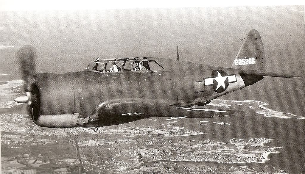

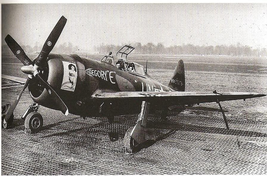

With all the talk about the Collins TP-51B, how about a lil respect for the "Doublebolt" P-47 conversion? This is one of my favorite "field conversions" and the subject of a recent model I built. I didn't like the color of the original though, so I went with the 9th air force, 348th fighter squadron paint job. I added the "Doublebolt" nose art for fun!!I tried to get the same shot "before" and "after"!
Here is the Original:

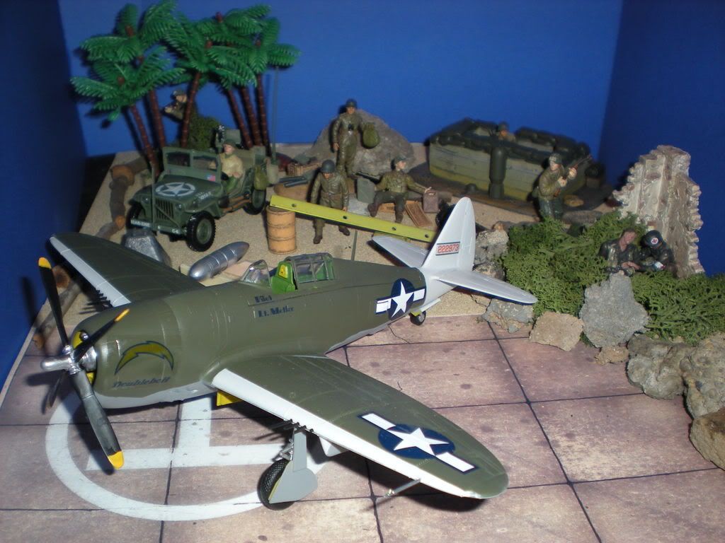

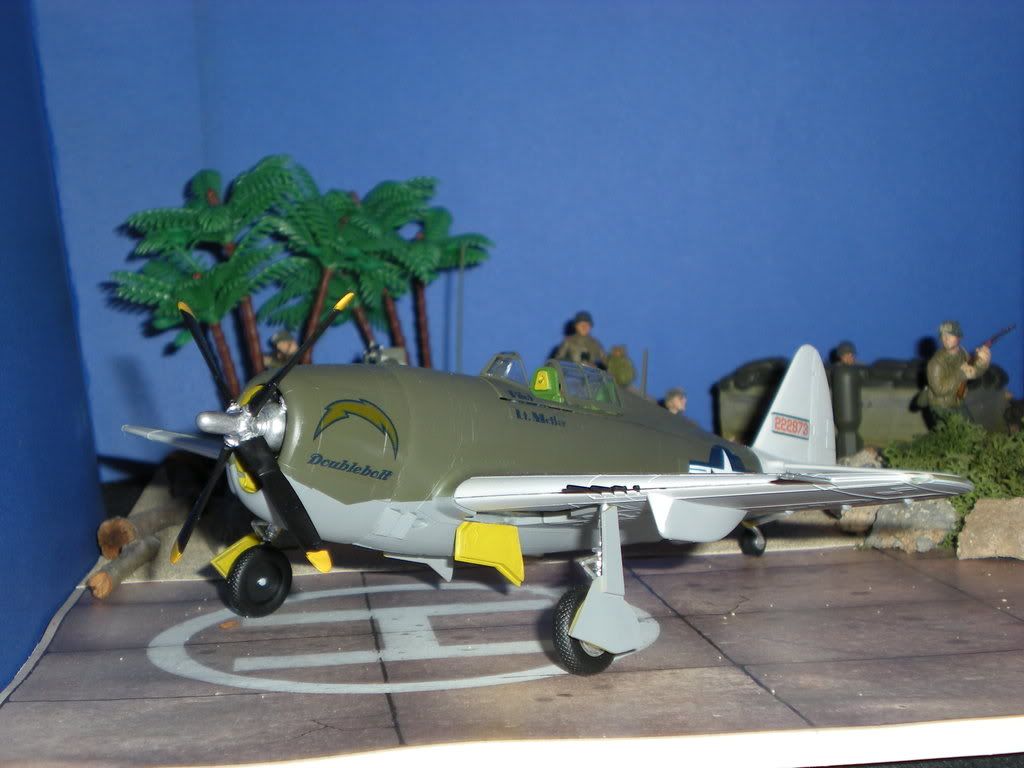

Here is my Version:

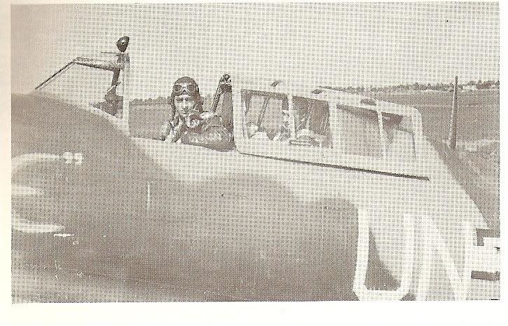

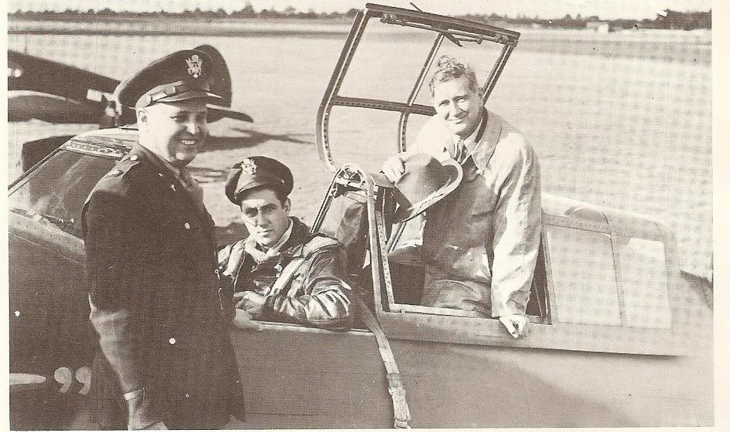

And some close ups of the original canopy:
I had alot of fun with the model and display. I hope some one on the WIX can contribute more pictures of this unique P-47 razorback.

Nice diorama, but I keep thinking that it looks like the props are backwards. Did you scratchbuild the whole thing? The reason that I ask is that most kits already have them molded correctly...

Ryan, the twist is right, he just has them installed with a negative pitch. :)
Guess it must've also been the testbed for the R2800 with a reversible pitch prop. :)

I thought the same thing and almost posted on it but I figured my old eyes were getting a bit older :-)
The prop looks like it's past the high pitch stops which is not normal for the Jug. Normally you would leave the prop in full increase for shutdown which is low pitch/high RPM. Makes it a whole lot easier to start :-))

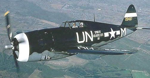

The PoF P-47 has a back seat or had. Steve Hinton was nice enough to give me a ride in it. It reminds one of a limo, not a sports car. It is big and stable and the engine is pretty quite with a much lower pitch than a Mustang or a Spitfire.

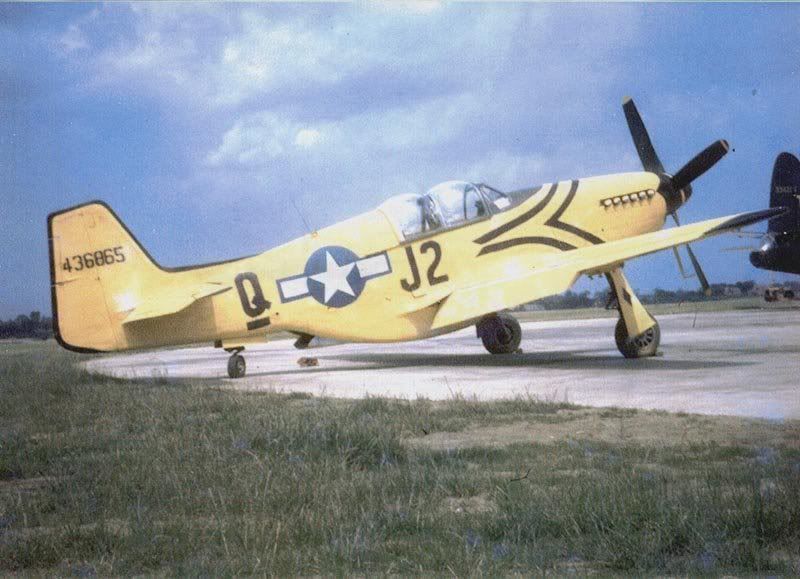

I wonder if theirs a decent pair of wings out there that someone can take and make an all new fuselage (or most of it anyways) and make essentially the Thunderbolt version of the CF's TP-51C?

Hello, the kit I used was just a cheap "Testors" kit. I cut the razorback down, added the headrest to the tunnel on the rear cockpit and redid the canopy. The kit is 1/48 scale so I was trying to find a T-6 or SBD canopy to use that would have been more accurate, but I could not find the right shape .I admit the prop looks wrong, it was awward to assemble and did not come out right. I was disapointed with the whole fit and finish of this kit, so I purchased a "Hasegawa" 1/48 kit P-47D razorback that seems much better. P-47 razorback kits are bit difficult to find these days at the model shop!

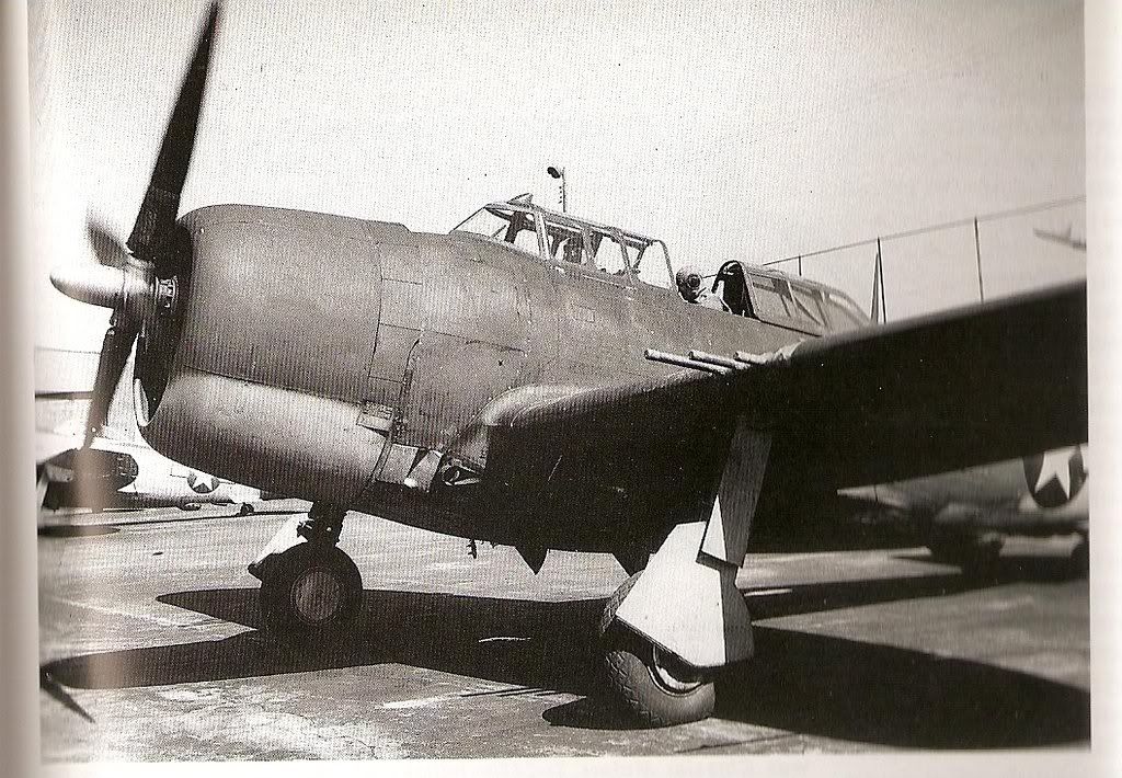

As for the debate regarding the "TP-47" conversion, I just think it would be hit on the airshow circuit. I don't advocate modifying an existing airframe, but a "newbuild" with a couple of original parts could be a starting point. The TP-51B is one of the greatest "mods" I have ever seen. To be technical the Curtiss TP-47G would the most accurate for a true two place, duel control. Here are some pics if have never heard of this:
Two Curtiss built P-47G-15-CU's were converted to TP-47G-16-CU status. The aircraft had full dual controls, operating turbosupercharger, full armament and had the upper half of the main fuel tank removed to make room for the conversion.

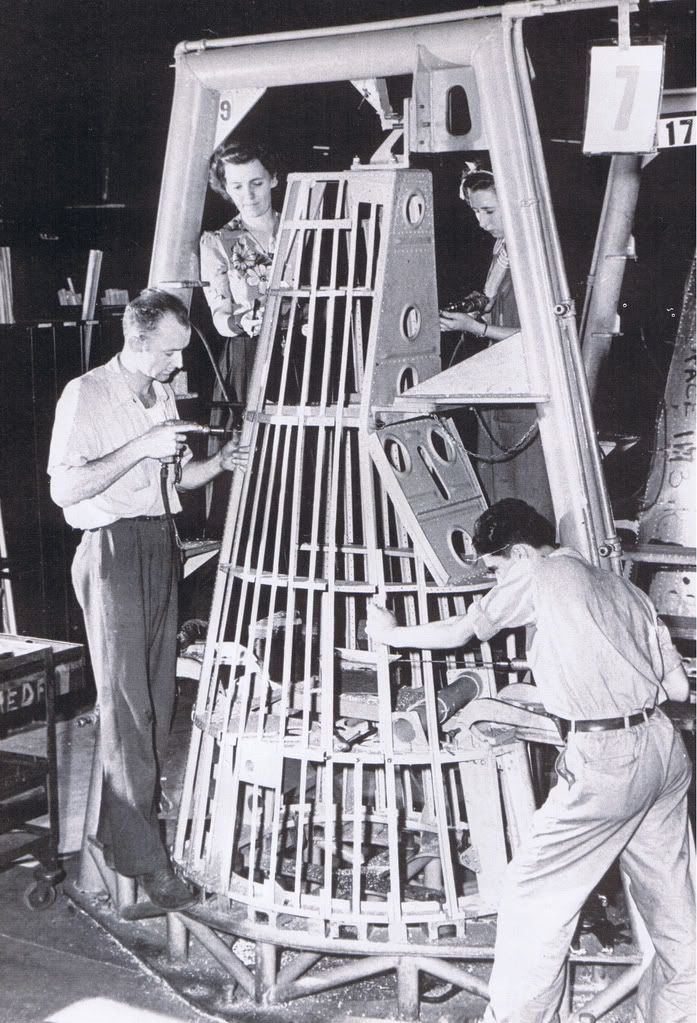

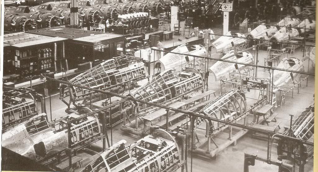

As for the fuselage, the P-47 is constructed in two halves with a seperate tail section. It is much more difficult to "reconstruct" than a P-51 Mustang.
Here are the upper sections pictured under construction:
And the tail section:

Love the Mustang hack!
