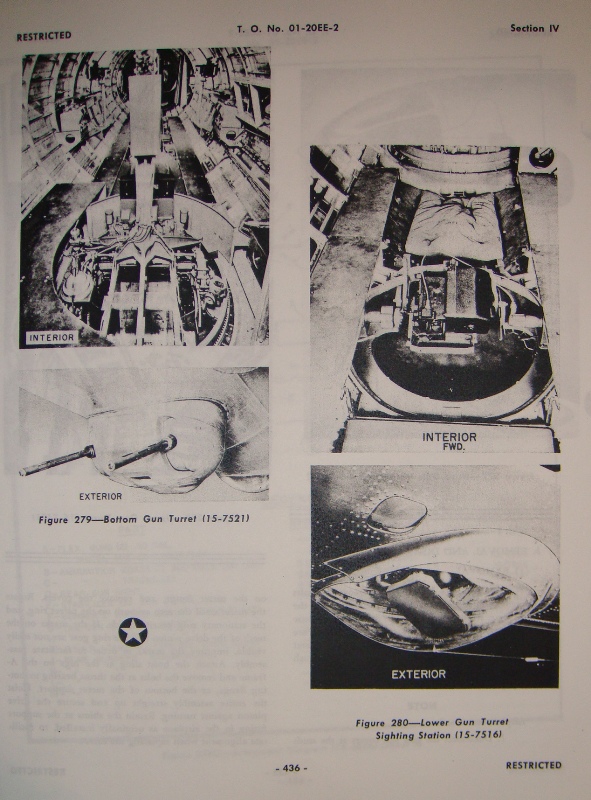

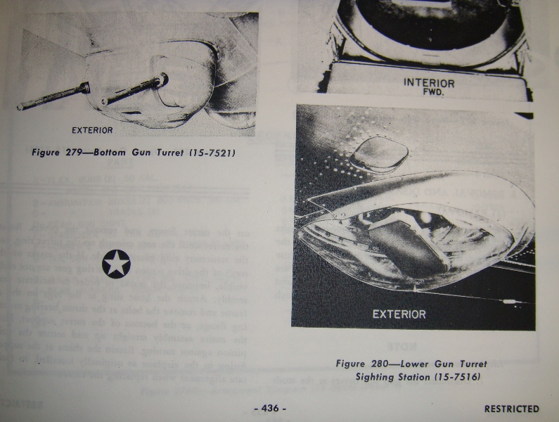

PostPosted: Thu Nov 13, 2008 9:27 pm
Posts: 1487
Don't mess with Scott he knows his stuff!
Here is some information on the Sperry lower turret in the B-17E which was a remote turret. The gunner had a separate sighting station aft of the turret. The dome for the Sperry lower was the same early dome used for the Sperry upper with the glass replaced with metal and a chute for spent cases and links.
The following is from TO 01-20EE-2 RB-17E erection and maintenance manual.
Check out the early version of the K-4 computing sight in the sighting station. I am amazed how early in WWII the computing sights were used.

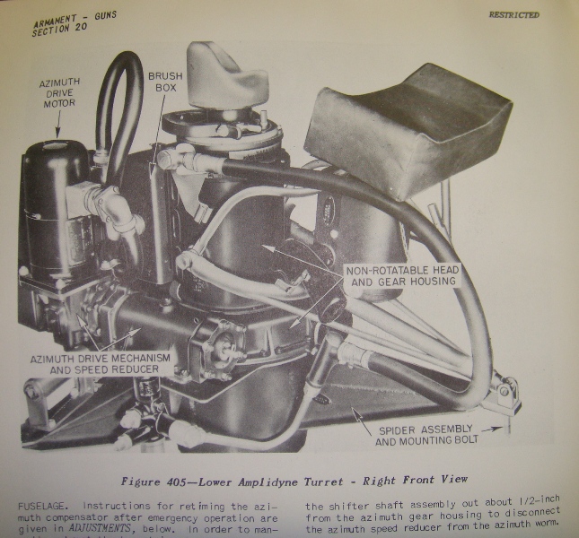

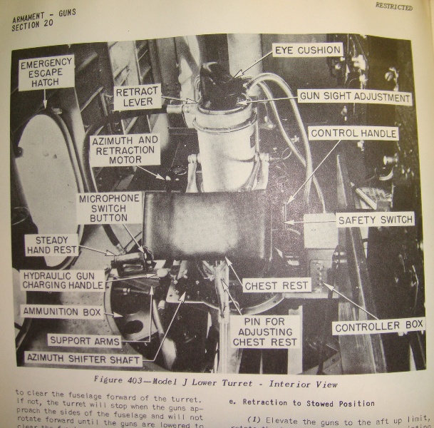

Here is the Bendix lower turret on the B-25 C&D that was sighted through the center of the turret with a periscope so it really isn't a remote turret. Note the resemblance and the obvious lineage to the Bendix chin turret on the late B-17's. Remember that this turret was retractable as it could hit the runway (or flight deck) on rotation or flare. You can see a good shot of this turret retracted in 30 seconds over Tokyo as they walk by it on the carrier deck. One minor flaw in the movie since the Doolittle Raiders didn't have this turret installed.
The information below is from the NAA factory maintenance manual on the B-25C&D
