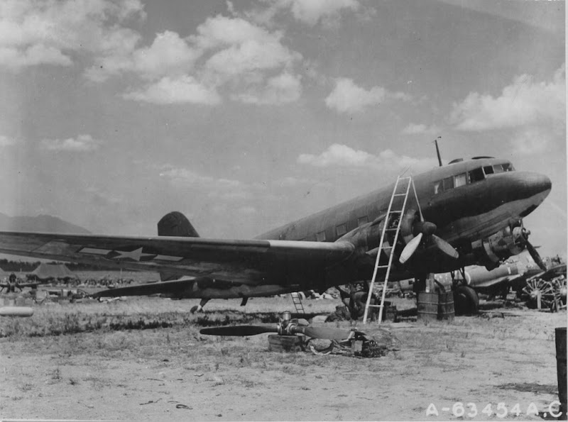

I did a bit of research on the Tabby a few years ago fro a model project. Structurally, the aircraft was similar to the DC-3 (NOT the C-47.) This means it had the earlier-style welded tube landing gear struts. Also, since the L2D was a Japanese cargo adaptation of the DC-3, the cargo door was different than a C-47 (a bit farther forward, and AFAIK no paratrooper jump door.)
Of course, the Tabby used Japanese engines and props.

I understand regarding the Tabby that the cockpit's rear bulkhead was further aft presumably to allow for a radio operator's station or flight engineer.
The Tabby had more cockpit windows too.

I believe the only version of the Tabby with an upper gun turret was the L2D3, and only a couple of prototypes of that version were built. It wasn't a turret as such, but a cupola with a hand-held flexible gun similar to the early Bettys, mounted above the navigator's compartment.
As Nathan mentioned, the L2D2 had extra windows extending back from the flight deck. It also had a round window in the forward crew door, and a small window in the underside of the nose (I didn't find out about that one until after I'd completed my model.) Another detail I didn't find out about until later was that the L2D didn't have the prominent leading edge landing lights of the DC-3/C-47.
Interestingly, as aluminum became scarce late in the war the Japanese were working on a version of the DC-3 made primarilly of wood. I've seen photos of the prototype in a dump after the war..not sure if it ever actually flew.
