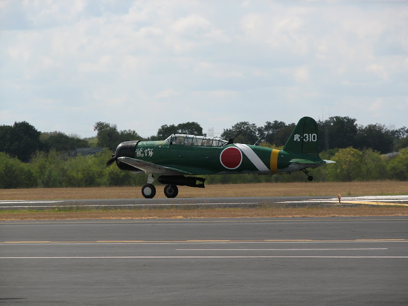

Posts: 4528
Gary,
Whatever the case as to what exactly failed - I can say that everything looked completely normal on takeoff from Stinson...
http://picasaweb.google.com/lh/photo/Sv ... 0FLvSx4oMw
See album link above for larger version
Congrats to Mr. McClure on a good landing and here's hoping 310's flying again soon.
Ryan
