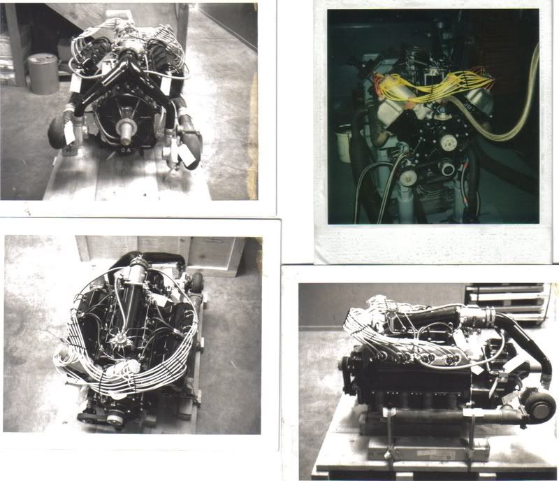

I worked for Ryan for many years as his fabricator.
www.falconerengines.com
One of the best engine guys ever in the biz dating back to the Granatelli NOVI days. The V-12 derived from small block Chevy geometry but was a ground up new production. 8.8" longer than a V-8 small block, tested and developed in his Suburban up and over the mountains in northern California. The Thunder project was amazing but unfortunately, financially troubled.

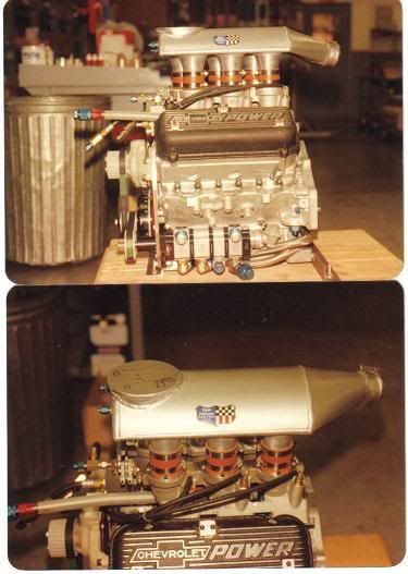

Ryan also developed a V-6 for IMSA (Dany Ongais/Interscope) and an all aluminum, splayed valve V-6 for Indy (Foyt). See below.

While with Ryan we did a number of stock block automotive engine conversions for Geschwender Aeromotive. These were Ford 427's and even a Chrysler hemi. Twin turbo but low RPM and very low boost. Just to give lots of torque and good power with reliability. Boy were they stump-pullers! :shock: Sorry for the crappy pics but you get the idea.
