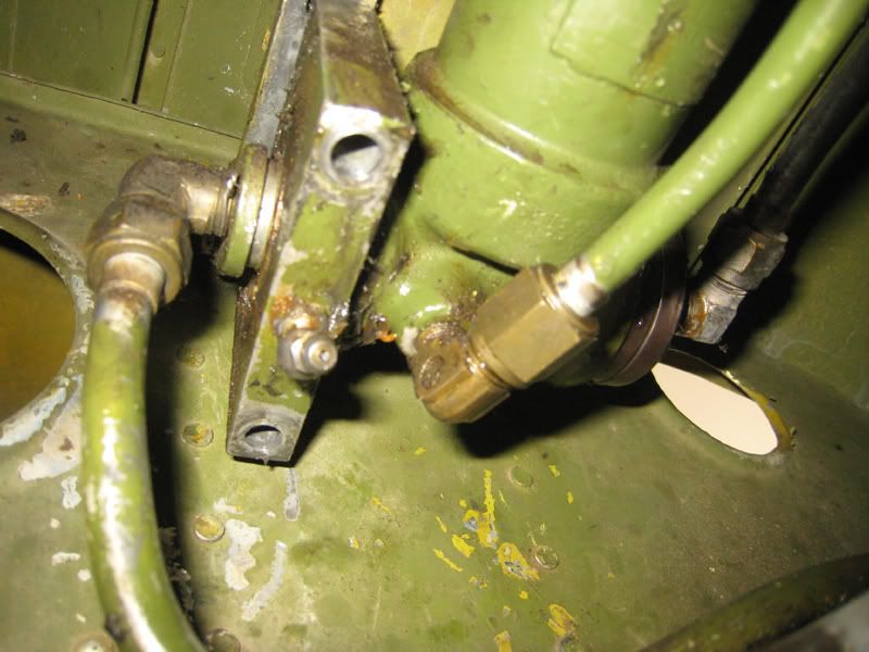

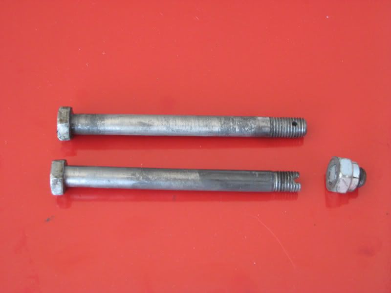

I was doing the annual on our T-6 and I noticed on the left LG retract cylinder that one of the mounting bolts was missing. Fortunately the nut was still there as was about a half inch of the bolt where it had sheared. The bolt was a drilled bolt and had sheared right at the cotter key hole. We pulled all the bolts and they were all drilled shank bolts. Needless to say they are being replaced. You may want to pull one or two of yours next time you do the annual. Just a heads up.

I am a little cornfused. Are those AN bolts? If the nut was only threaded on as far as the cotter pin hole (where it failed), how could you have three threads protruding from the end of the nut? That would have to be a bolt with extra long threads AND a cotter pin hole drilled close to the shank. Never seen anything like that in a fastener catalog!

I should clarify the picture a bit. The bolt that was attached to the nut with the end of the bolt still protruding was gone. It may or may not have been an aircraft bolt. The nut was wedged in there pretty good. The bolt that was sheared in the picture was one I removed from one of the other mounting holes. The other bolt was still intact but was there just to show that it was a drilled bolt. Good point though BDK. That's why I'm throwing out the heads up deal.

if I recall correctly, is ia a standard AN bolt, but it is a long sucker. It has to go thru the retract cylinder mounting blocks, the mounting flange, and nut. The nut is captured, otherwise it would be a royal pain to get it out.

And you shouldn't use drilled shank bolts with locking nuts, especially Nylocks as the holes tend to cut the locking material out.

I would use a bolt next time without the hole if your using self locking nuts. You are techniccaly supposed to use self locking once. If you are going to use bolts with the hole at the end use a castleated nut and cotter pin.. You probably allready know this but just in case :)

The bolts are the wrong ones per the parts book, so is the nut. Also anyone using an AN363 on a drilled bolt are just asking for exactly what happened.
Check your parts manual, I just OH both gear actuators in a G model and yes the nuts are semi captured. They will not come out unless the bolt is removed.
Last, I would double check your gear rigging per the manual. Looks to me like the throws on the Actuating cyl were off causing a constant load, thus over time the vibration simply cut thru the weak point, the drilled hole.
Once again, use the correct hardware, if you dont have it, GET IT !!

I ordered the correct bolts this morning. AN 5-33A. I'll check the rigging too but in the picture, all of the bolts have been pulled thus making it look like the cylinder is out of whack. Thanks for the tip

And reference your comment, you need to check the alignment of the cyl shaft. When I recently rebuilt 2 gear sets, the washers used as spacers on the gear cyl were not correct, probably due to wear or hard use thru the years. Dont assume the washers will be re installed as before. Measure everthing per the manual as if it were a new install.

When you check the rigging, the uplock roller should be in the middle of the hook when pressure is on the system, niether touching the top or bottom of the hook. If there is upward pressure, it will bend the pivot bolt on the uplock hook.
