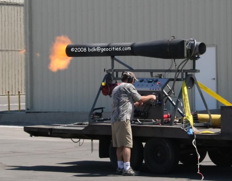

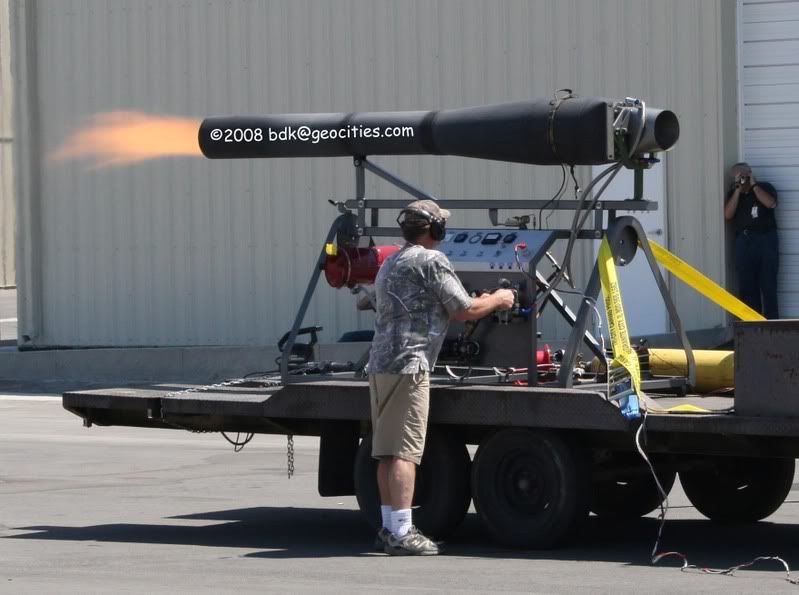

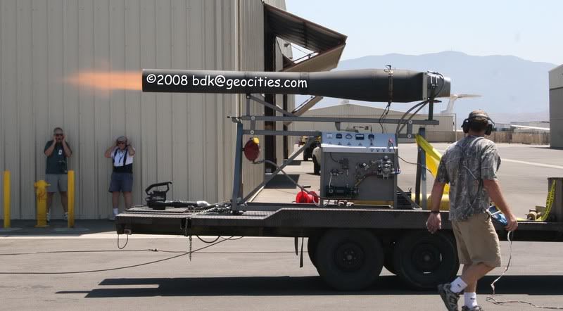

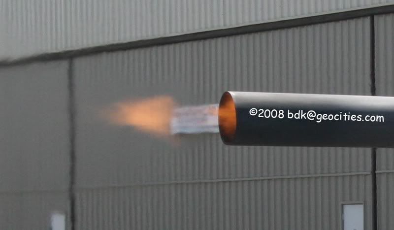

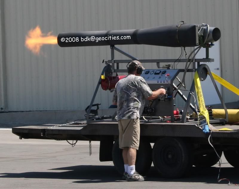

Well, a (Ford built) JB-2 Loon engine at least... An exact copy of the V-1 engine:
And it does have thrust! It pushed the trailer and the full size SUV it was attached to (in nuetral of course):
P.S. I only posted photos with exhaust flame showing otherwise there's no other way to tell it was running...

OK. So how does this work, then? I understood that the pulsejet needed forward movement to ram air into the intake - which is why the V-1 was ramp launched to get engine (not flying) speed?
Or is it modified? Or very inefficient at low speeds but still runs? (Which implies that if it manages to get that SUV above 'x' speed, it'll take some catching... :D

No forward speed required, just lots of fuel. A ram jet is the one that requires forward motion (and quite fast at that) to run.
Basically it is a tube with shutters (one way valves) at one end. When the mixture ignites the fireball gets pushed out the back, creating a vacuum in the duct which causes the shutters to open and draw in more air. The length of the duct causes a resonant wave to come back into the combustion chamber to create compression. Combusion takes place again and the cycle repeats. A spark plug is used for starting, once up to temperature it should run without a spark. Primarily the length of the duct dictates the pulse rate. They are not easily throttled because the resonant forces in the duct are actually quite weak and the duct pressure is low.
There's quite a lot of info on the internet about pulse jets. The valveless ones are quite simple to build in fact and one was featured on the cable TV show Junkyard Wars.
http://en.wikipedia.org/wiki/Pulse_jet_engine
http://aardvark.co.nz/pjet/scrapheap.shtml

PostPosted: Mon Aug 18, 2008 12:20 am
Great post BDK! I spent a good chunk of a day awhile back revisiting pulsejet technology and history.
An amazing detail about the combustion cycle you explained, is that it occurs several hundred times per second.
How did they start this one? I've read the larger engines often used another gas(propane, etc.) or a
fuel pump to inject the running fuel into the combustion chamber to start them. Just curious. Neat schtuff! :wink:
PostPosted: Mon Aug 18, 2008 12:37 am
Posts: 11332
The reason they couldn't drive the rig around the airport was because the extension cord to run the fuel pump wasn't long enough.
I think the sequence was ignition and then fuel. That's it. They had a leaf blower to blow out any fires from pooled fuel. Sometimes it would kaboom on startup, sounded like a stick of dynamite in a metal trash can- not that I've heard one of those.
Yep, that's how I understand it. They use a multi-spark ignition..once she fires...MSD is switched OFF and the
combustion cycle is self supporting as long as the fuel lasts.
They are critical in their power output when you mess with exhaust tube length and intake orifice...if
you could adjust those "on the fly", you could crudely achieve a throttle. That's what I gather... :roll: :D
