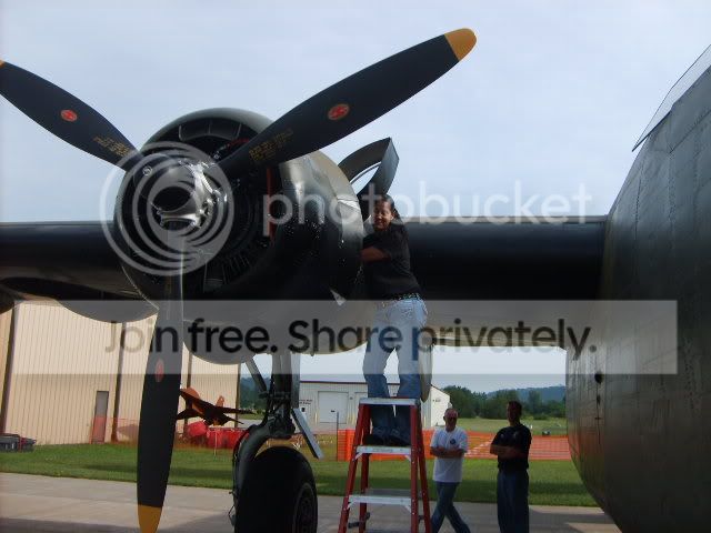

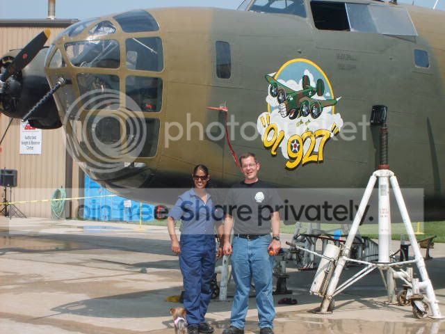

Pics from the Jack Job
Sun Aug 03, 2008 5:03 pm
Image[/img]
Sun Aug 03, 2008 5:38 pm
Excellent effort by all! You should be commended for the hard work expended to get the ole gal operational again. Having jacked and run gear tests on the KC-135, I never had to do it outside. I can understand the concern of weather, idiots in helicopters and all, bringing your freak-out meter to it's max! Again, good job and thanks for the pics. Not everyday you see this done on a classic bird!

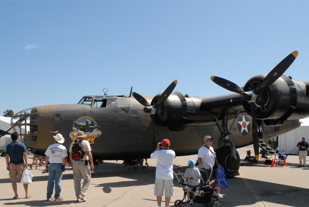

Picture of her at her destination, Oshkosh!
From a fellow in the game forum I post in.
