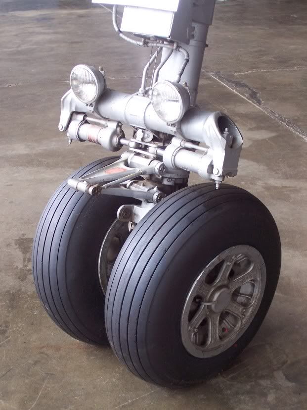

Can anyone help me I.D. what Grumman aircraft these parts are from? I have had them over thirty years. (and they were old/used looking, even then)
The black & silver Grumman part ID tags read
Grumman Aircraft Eng. Corp.
Mfd. By EX-CELL-O Corp.
Part # 177550 & (stamped) 5 X G
Ser. # 849
INK-stamped in black on body: Ohauled Alameda, ASC 177 1966
Second one Mfd. by Chicago Pneumatic Corp
part # WT-1953 5 J
They are Heavy and at widest OD are 6 inches and approx 22 inches long, as in photo.

Looks like the shimmy dampers from a Connie nose gear..
PostPosted: Fri Jul 18, 2008 12:48 pm
Posts: 2309
ok, maybe not..

10in of travel? oilcooler door actuator? flaps? undercart door?

Hmmm.....they do look a lot like these don't they???? Found this here on WIX

Your cylinders sure do look familiar... and given your description and the visual I think they're the wing folding hydraulic pots for the F9F Cougar or Panther series a/c. The OH tags and the 1960s OH dates would be consistant with line service USN stuff ( I had a Cougar ejection seat with - get this - 1974 OH data stamps all over it! ).
I have a Cougar and Panther manual around here somewhere and will find it and cross-reference the part numbers for you. Lacking my ability to grab hold of the manual anytime soon, I'll check our hydraulic inventory here on the hangar shelves to gain access to the Grumman hydraulics we have and check 'em against that. I know for a fact we ended up with Panther and Cougar parts years ago.

Definitely different than the ones in the image shown by Wheels Up, above.

Thats actually one of the photos that I posted about the Grumman Tracker parts we have up for sale. I originally thought that you cylinder might be one for our tail retract system but the fittings and size don't quite match up. I also never remember seeing one quite like that in the Tracker but I could be wrong.
