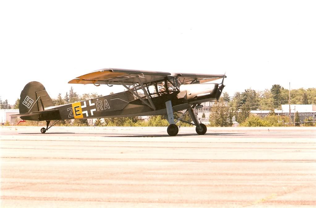

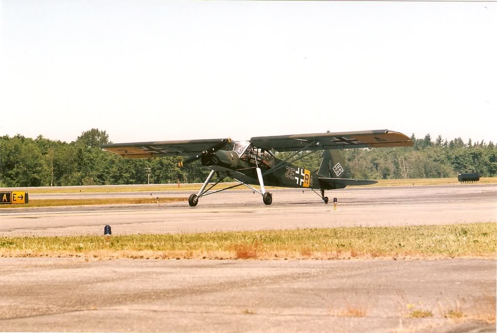

This is not a fly by he stopped the airplane and hovered for a bit!!!!

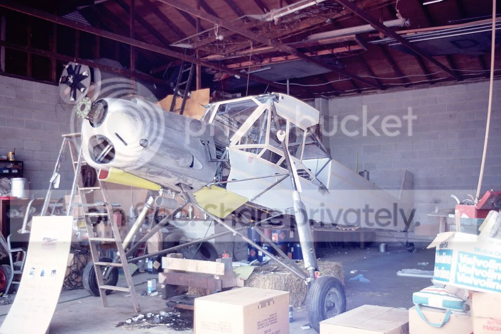

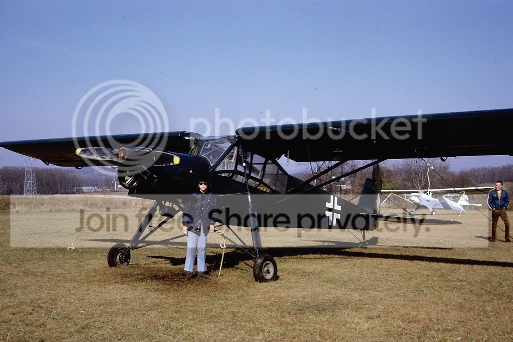

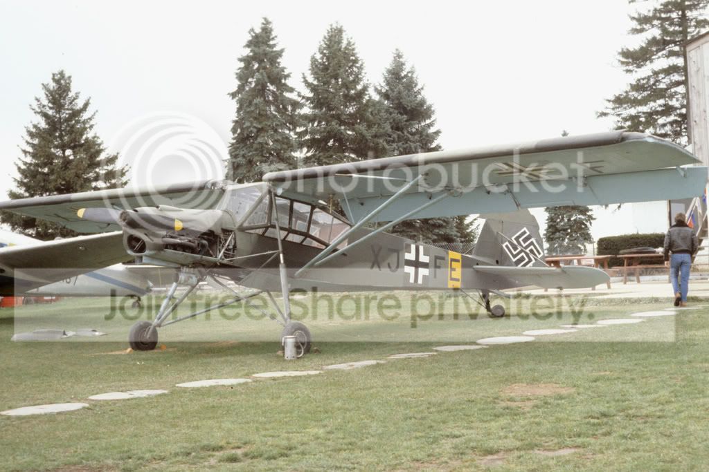

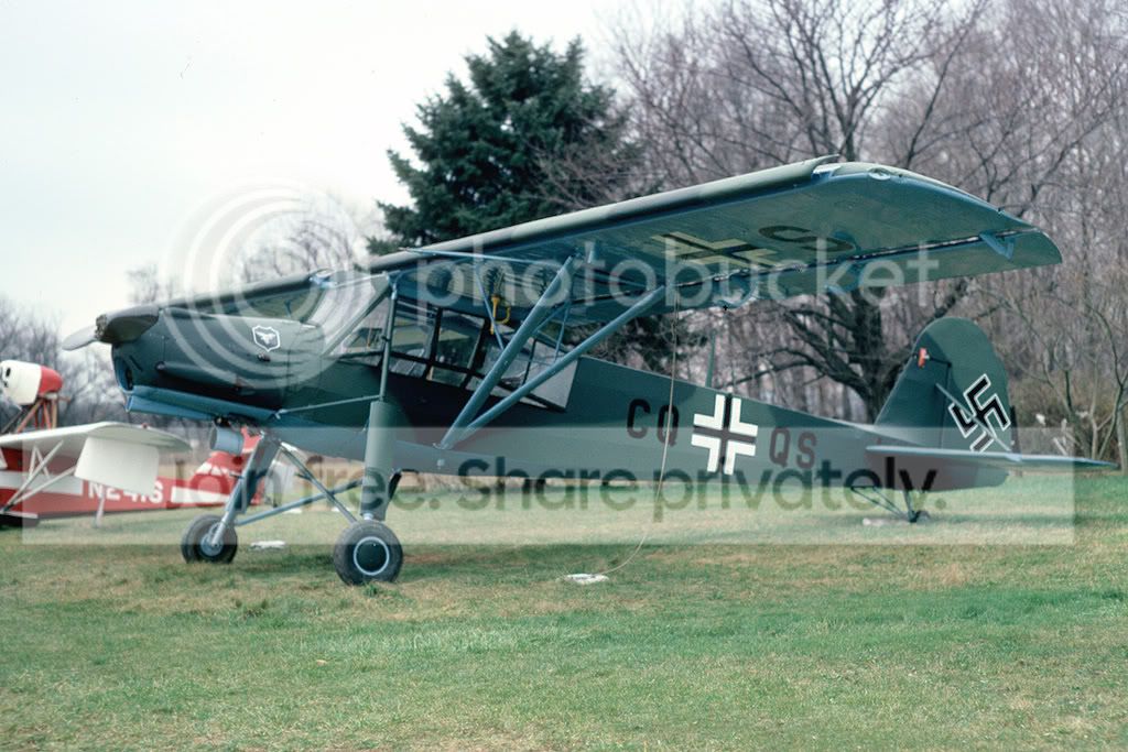

Speaking of Storchs, in the '70s Sky Manor Airport in Pittstown, NJ was a haven for Storchs (at least some were Nord-built). Anyone have any idea of what happened to these?

Ok now a couple of comments on this Storch post.
While at Air Heritage I worked on David Tallichet MS 500/Fi 156 for over a year or so. So I learned a thing or two about the airplane.
On the first picture of the post, I noticed that there are no fuel quantity indicators on the bottom of the wings. Also I did not see the rubber fuel hose’s that hang off the trailing edge of the wing and allow the wings to be folded without messing with the fuel system. So I wonder if this Storch wings can be folded at all.
On the second picture I did see the rifle type pilot tube along with the tear drop landing light. Also it appears that the pilot has a little flap in for the take off as the ailerons seem to be drooping a little.
On the slow pass third picture of the post, it seems that there is a pretty good head wind if the pilot can bring the airplane to a hover with no flaps. If I member right that would be around 30 to 35 mph, with the flaps down the head wind required would be around 20 to 25.
We laid out one wing and put the flap and aileron on and connected all the torque tubes to see how the flaps would interact with the ailerons. With the flaps in the up position the ailerons would act in the normal way. But with the flaps down the ailerons would droop down. When we operated the aileron torque tube what happen was very interesting, With full aileron input the aileron would only move to the neutral position with the wing from the drooped position. With full input in the other direction the aileron would go below its drooped position.
So with the flaps down only one aileron would input the airplanes attitude with the other in a neutral position with the wing. The wing is full of torque tubes and bell cranks that interconnect the flap and the aileron. There are no cables in the wings only torque tubes.

I enjoyed the "Hover" pic. I remember seeing a Storch (Collings?) do that at an airshow here in (Sussex) NJ once. It was very cool to see. :D

Rich,
Neat photos. They are Moraine-Saulniers not not Nords. Who knew PA was such a Storch hub.
No idea on the first or second airplanes, but third plane is F-BJQA now in Europe somewhere and the last one is N57962 now at Planes of Fame.

Yes, it was blowing about 20 with gusts to 24-25 @ the time of the demo last Saturday.
The thing that struck me was the 300 horse Argus engine sounded for all the world like a WRIGHT J-5, you could almost hear the pistons going up and down in that rolling clatterlike rumble that a 975 has-
