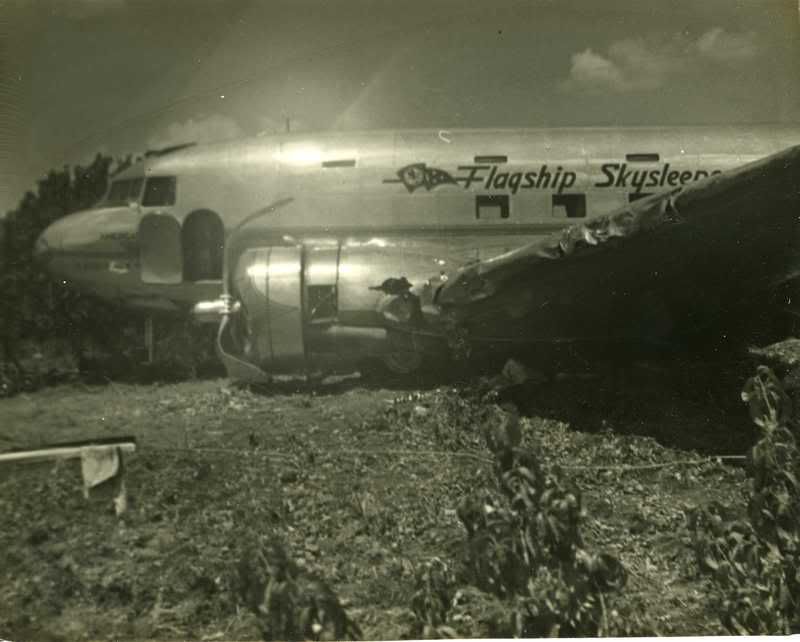

A couple of questions for those in the know...
When did the military start using civilian airliners for military purposes? Was there a definitive start date? When these aircraft were used, I know that some were given full military paint schemes and were assigned serial numbers. Did some fly in their civilian colors for a period of time?
I ask prompted by the following photos:
The aircraft pictured is the Flagship New York, NC16001. It was a Douglas Sleeper Transport (DST), and was the first DST American Airlines received. Obviously military personnel are part of the crash scene, so I'm guessing that it had been pressed into military service by that point. Does anyone have any information on the crash?
At any rate, I thought it was a neat, probably rare look at a forgotten part of our WWII history.
Thanks!
kevin

Lost the link but this lists the following-
42-56092/56097 Douglas C-49E
American Airlines DSTs commandeered by USAAF.
56097 DST-144 c/n 1495 ex NC16001. To DSC Jun 08, 1942. Crashed Biggs Field,
Ft Bliss, TX. Dec 18, 1943.

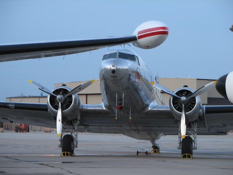

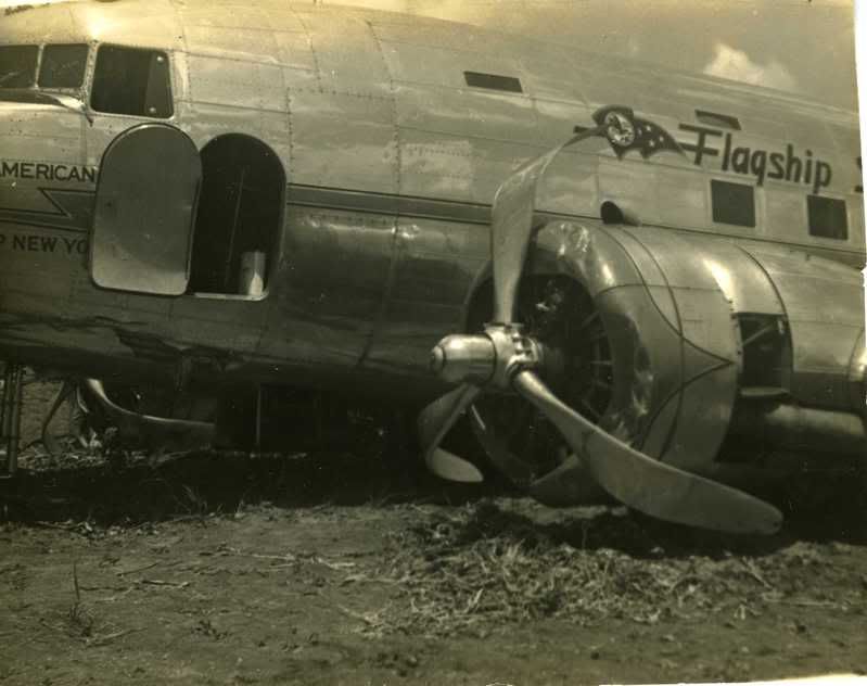

I have a copy of a pretty good book pertaining to the airlines and WWII titled "When The Airlines Went To War" by Robert J. Serling. According to this reference, the final meeting between the government and the airlines occurred on 15 May, 1942. The Army requisitioned 193 aircraft out of a total of 359 commercial airliners on that date. It's interesting that many of the airplanes were immediately put into service on military missions with airline company crews and in the original livery like the pictures posted by Kevin.
Your second photo shows the Wright cowling setup very well, including the little flat spot at the top of the opening we talked about on the FST thread.

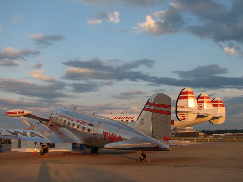

I believe that above info is not right, as for NC1945 The Airline History Museam here in KC is restoring NC1945. And all the records we have Show she was not sent to the Army at all and was used for VIP service with TWA during the war and was with TWA untill 1952.
Here are some shots From the KC airshow last year. The billboard over the windows is the one she had during WWII "Cool" Yes??? She is coming out again for this years show too. Aug. 23-24

Is it possible your airframe is a later s/n that was actually issued the registration "NC1945" and entered service in TWA, is your a/c s/n 3270?
the info above is quoted from Kelly's book ,but in agreement with the following info from a reputable US historian website:
http://home.att.net/~jbaugher/1941_2.html
Douglas C-49-DO DC-3-384 aircraft impressed by USAAF before delivery to TWA. Civil registrations NC1945 thru
NC1949 were assigned but never taken up.
It seems your aircraft IS a different and later production aircraft and is s/n 3294, which obviously did then have the civil registration NC1949 issued to it as left over from the impressed aircraft.
below extract is from the Airline History Museum website
http://www.airlinehistorymuseum.com/dc-3.htm
Douglas Commercial DC-3
NC1945
The legendary Douglas DC-3 is the latest restoration project by the AHM. This Douglas DC-3-362, registration number NC1945, serial number 3294, was built in Santa Monica, California, in February 1941. It was delivered to Transcontinental and Western Airlines (TWA) at Kansas City, Missouri on March 4, 1941.
About sixty percent of all DC-3 aircraft went to war in WWII as transports; this one did not. In fact, NC1945 is one of the very few existing DC-3s with the rare 24-passenger, 8-window configuration. Most remaining DC-3s are of the 21-passenger, 7-window configuration. This airplane flew with TWA as ship 386, from 1941 until 1952. In fact, some of our members logged hours in this plane as TWA crewmembers. It then spent 14 years with North Central Airlines. In 1968 it went into charter operations, and later was a travel club airplane with Coronado Airlines, in California.
