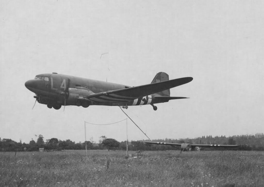

Please enlighten me with this evolution and the C-47's equiptment.
I've never seen this before. This was the first snatch n grab in liberated France!!

I've seen that proceedure in many photographs and film. They performed it quite often, though I don't have specifics.
Used many times to retrive undamaged gliders without having to take the time to disassemble them.

found the original caption to your photo:
A glider snatch was accomplished by a C-47 tow plane flying just above ground level with a hook trailing behind from a cable that played out from a revolving drum in its fuselage. The hook snagged a glider towrope suspended between two vertical poles sweeping it airborne behind the tow plane from a dead standstill to 120 mph in a matter of 7 seconds.
Taken by Yves Tariel of Paris, France, this is a picture of the pick-up of the first glider to be recovered from the Normandy landings. It was taken on June 23, 1944 as the glider was being snatched from a field just SE of St. Mere Eglise France, by 1st Lt. Gerald "Bud" Berry, 91st TCSq, 439th TCGp.
some interesting info & photos here:
http://www.pointvista.com/WW2GliderPilo ... rieval.htm

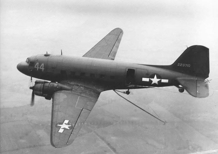

the same 'contraption' is seen on this C-47 towboat
Martin

I've always wondered how they didn't just rip the cable right off the glider from the force of going from a dead stop to airborne in a few seconds.

"It's prolly a C-53....they were rigged for glider towing"
http://www.xs4all.nl/~fbonne/warbirds/w ... c47verstab
And the ID of that plane is:
http://www.ww2gp.org/CG4A.htm
(also a note of the a/c rigging for towing)
:wink:

Django wrote:I've always wondered how they didn't just rip the cable right off the glider from the force of going from a dead stop to airborne in a few seconds.
The line which payed out from the drum in the tow aircraft was steel. The "snatch line" draped across
the poles was Nylon and stretched somewhat like a bungee cord. The design of the winch played a large
part in gradually transferring the load of the static target to the towbird and reeling them in.
If you go back to the thread Wheels Up linked to about the Dreamflight 2009 project Gliderman1 and I (starting page 3)
start to get into the "bits and pieces" of the apparatus. He and I disagree on a few points..but it was a pretty fascinating
discussion for me...there ain't a lot of material on this subject on the web or in books, for that matter.

Glider Snatch/Pickup. My WWII outfit, the 316th TCG, only did the snatch as training. We never really used this technique under combat circumstances.
But: I suggest you read the book “Into the Valley, The Untold Story of USAAF Troop Carrier in World War II: by Col. Charles H. Young. Young was the CO of the 439th TCG.
On pages 467-469 is the story “Remagen Glider Snatch of Medical Evacuees.”
“Utilized ‘live’ at Remagen [Germany] for the first time in the ETO, the evacuation of ‘litter cases’ by glider was to be used in the invasion area of VARSITY if the link-up between airborne and ground forces was delayed.” This first evacuation flight took place on March 22, 1945.
These three pages not only contain the description of the technique of the snatch but also has illustrations of the mechanics that were necessary to install in the C-47 for the snatch technique. Also included on page 468 is a “Nurse’s Perspective (on the Second Remagen Pick-up).”
There is much more to read than what I can send. The material was written by Gerald C. “Bud” Berry. I believe he also was with the 439th.
