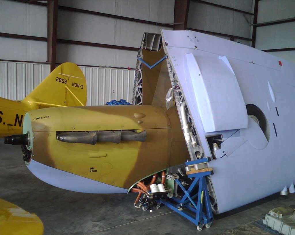

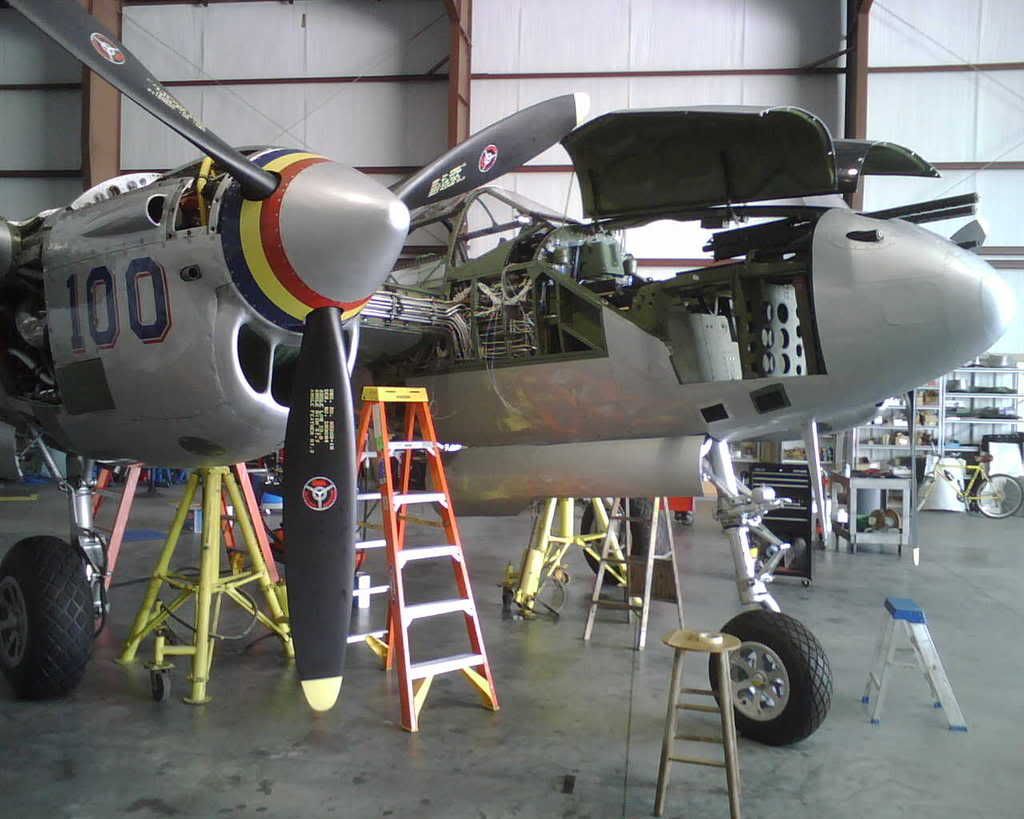

Blair P-38 yesterday at stallion 51 in final stages of re-assembly after complete overhaul and JG-891 fresh out of the box from Duxford, soon to be re-assembled and defending the skies of Florida.

More on the Spit, plz! 8) :lol: :o :wink: :shock: :D

Wade there are some pictures of the Spit here on its last flight before crating up,also some excellent ones of Duxford and the Fighter colection in particular.

I believe that Spit was on the cover of Air & Space a month or two ago... and it looks awesome! 8) One of the best covers that magazine has had IMO.

will the P-38 be staying in its "Putt Putt Maru" scheme?
Defending against whom, Bahamas..? :wink:

The P-38 will be painted in new colors.

OK Wade ! These are from Flying Legends 2007 at Duxford Airfield.
You'll have already noted that at that time it was the only Spitfire in the world flying with a Volkes fitler fitted under the nose. This plus the color scheme gave it a very distinctive look.
The Volkes filter as now been removed ( I've read that it really degrades engine performance )

I don't know what it is, but I really like the look of the Volkes filter.
I didn't know that it degraded engine performance. Interesting.

It's the tropical filter I believe. Could they run it without the filters in place? Is it getting repainted as well?
What scheme for the P-38.
The both look fantastic as they sit!

The air filter on a Spitfire is designed to only be used for taxi, takeoff, and landing, down where the dust is. Once you climb into clean air, you open the door to by- pass the filter to go directly to ram air. I don't think the Volkes filter would degrade enginge performance much, if at all, once the ram air door is open. This is the small flat metal flap about a foot wide and 4 in high seen at the front of the scoop under the engine. The larger and deeper fliter is more of an aerodynamic drag and would likely cut 15 mph off the top speed. I am guessing as I have no direct experience with a Volkes filter.
Django, it could be run without the filter, however it would make no sense. In dusty conditions like taxing on the grass at Oshkosh, you would have the dirty air coming straight in the front and going back and up into the carburetor and the intake into the engine. With the front door closed air is drawn from inside the cowling down through the filter box, then the clean air goes up to the carb.

Good job showing the tail of a N3N :shock: :?
You know what that'll lead to :twisted: :twisted: :twisted: :wink: :wink:
