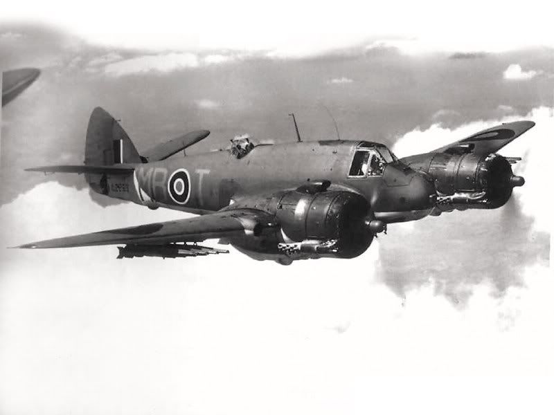

As seen on a Beaufighter:
I didn't know about the hedgehog name. Learned something again!

I don't think there's anything 'clever' it's just a selection of slots sticking out, rather than a single port. Bear in mind that most of the examples above were a single exhaust that ran off a collector ring, which (I presume) suppressed most of the visible flame at night. I'll ask next time I'm talking to a Boomer expert. The Beau and the Hali were Bristol powered, with the collector ring at the leading edge of the cowling; common British practice, unusual, I think, in the US. Bristol engine data will give you more.

I wouldn't underestimate the engineers of the day, James. I think the design is
is quite clever! The exhaust exits from the ring, hitting the capped-off stack and possibly exit back forward thru the
porcupine vents...They would have to figure what the volume of exhaust to exit and account
for effects on engine performance...an interesting compromise for an engine tuner.
EDIT:
I'd be interested to see what the stack looks like internally coming out of the collector..is it a solid tube, or is it
"drilled" with holes like a silencer on a gun?
