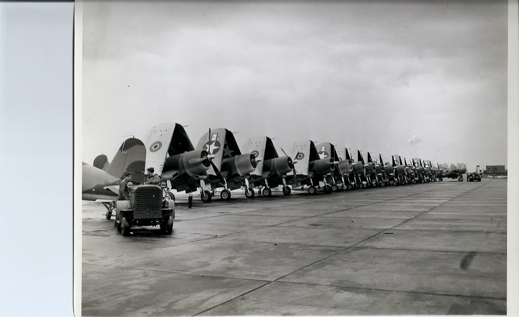

This picture of these royal navy corsairs caught my eye today.It looks like these aircraft are at the vought factory in Stratford. Did they clip the wings in production,put there colors on them out of the factory, or is this pic. not taken in the states :?There is two pics below at the vought hangers.Just curiious thanks.

Corsair wing panels were manufactured by Briggs and Stratton as I recall, and the battle to get the wings shortened by 8 inches so they would fit on British carrier hangar decks was a lengthy one, with several options offered by the Vought factory, including compressing the oleo struts, or deflating the tires....in the end, cutting 8 inches off of each outer wing panel was the practical solution and effectively gave a few benefits, 2 of then being a slightly faster roll rate and a slightly less 'float' on landing, making carrier landings more controllable.....and yes the British Corsairs were frequently delivered with British roundels already applied.

The wings were made by the Briggs Manufacturing Company. I am not sure that they are related to the current day Briggs & Stratten, but it would make sense that they were. The clipped wings were produced at the factory, although it is possible that some of the earlier deliveries were retrofitted in England. The fix for the problem was actually quite straight forward in the end, although there was a lot of debate over how to do it (as Mark pointed out). They just deleted the last 10"s or so of the wing tip. No cutting was needed, as there was no spar by that point. They just faired over the end, which resulted in a reduction of 8" per wing.

From the book 'Warbird History: F4U Corsair' by Nick Veronico and John and Donna Campbell...pg.35, 'Britain takes the Corsair to war'...word for word...the number 3 solution out of nine was "Compress the main landing gear oleos with a specially designed oleo jack, or fully deflate them. (Rex Beisel, the designer of the Corsair, stated that this idea would not be practical because of the danger involved in compressing the high pressure oleos, nor would it be practical due to storage space required for the jacks-two per aircraft). In retrospect, and upon seeing so many different and in many cases impractical solutions for shortening the overall folded wing height of the Corsair, the British just decided to remodel the wing by shortening it 8 inches and aircraft that had already been delivered to the UK were modified by Blackburn aircraft Co. and by another company in New Jersey, while modifications were employed on the construction line from Corsair BuNo 17952 on for the British and NZ Corsairs.

In the Aircraft Log Book for the Cavanaugh Corsair, the first page shows it as an FG-1D, Mfg No. 3660 with an Aircraft Number of V92399.
The second page lists the aircraft as a Corsair IV, accepted from Goodyear Aircraft Corp on July 5th 1945 at U.S. Naval Air Station Norfolk, VA. The aircraft was then transferred to NAS, Jacksonville, Florida on 12th March 1946 arriving with a total of 10.5 hours on the airframe.
The first entry for Jacksonville is "Transfer to A &R for modification by verbal order from the staff".
The next log entry on 8th April 1946 lists:
"This Airplane was modified from British Configuration to U.S.Navy Class "C" Configuration in accordance with Engineering Control Board Report attached".
This would definitely confirm that the last "batch" of British Corsairs (which was originally destined for the Fleet Air Arm before the contract was cancelled) were built to the "British" spec at the factory before delivery.
