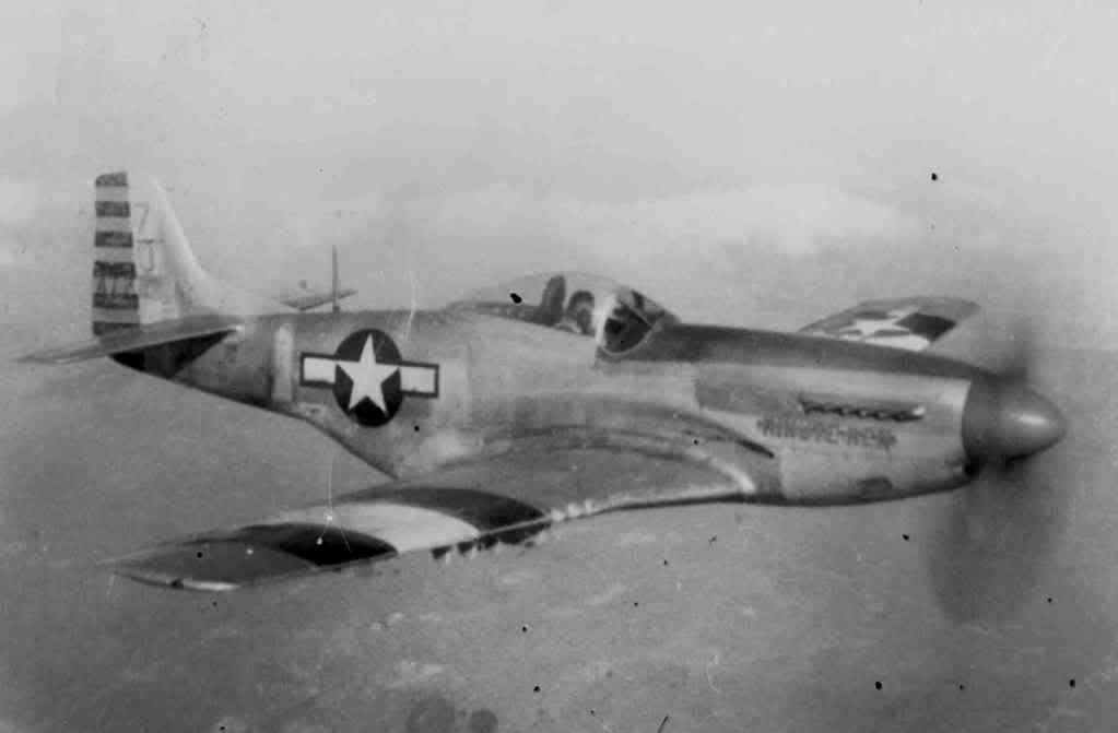

A WW2 dash 25 in such raggy looking condition........rare photo.

All you Mustang and Merlin experts...
This photo is cool in that it shows a lot of oil coming out the breather line. What causes this? Is it more high rpm operation, or was this guy out doing acro and maybe got some negative G in there?
Dis the P-51D-25 come with a -7, -9 or were they interchanged through production?
Just curious. Thanks.
Scotty G
www.LightAndLift.com
www.WarbirdAeroPress.com
PostPosted: Fri Feb 22, 2008 3:41 am
If this is truly a breather line vent and the piston rings are as tired as the aircraft looks,
I'd surmise as a motorhead.. chronic excess crankcase pressure. :shock:
PostPosted: Fri Feb 22, 2008 5:05 am
Posts: 1068
Location: Illinois, USA
Most likely negative G or less than positive !G maneuvering causes this crankcase vent streaking. Current civilian Mustangs have the vents located below the wing chord line in the area of the bottom of the coolant scoop. This keeps the slop off the fuselage.
I believe the -25 came only with the -7 motor. The -30 would have had the -9 motor......someone might double check this.
VL
PostPosted: Fri Feb 22, 2008 6:03 am
Posts: 1521
sorry guys... it's a D-20-NA in the 44-723xx range....
the panel behind the windshield above the instrument panel is smooth - on D-25-NA's there were 'bumps'
sorry to be picky
the whole production of P-51D's came with V-1650-7 - the P-51H had the -9
of course some earlier a/c were retrofitted with -9's but it wasn't production standard at any time during the D- production
Martin

Wow, Martin! You could see that it had no 'bumps'?.........I need glasses!!
These are the two small raised 'ridges' on the angled section of the instrument panel glare shield. Good catch.

PostPosted: Fri Feb 22, 2008 4:58 pm
Posts: 392
Scotty -- the breather comes from the valve covers and any time you're negative the oil goes to the top of the valve cover and then out the breather. If you look at photos of Patty Wagstaff flying Princess at the Gathering you'll see a big oil stain down the right side because of going negative (yes I had a heart attack but have recovered). Jim

There's a photo is Jeff Ethell's T-6 book "Pilot Maker" showing a RAAF P-51D after the pilot got a little carried away doing a acro demonstration. The whole side of it is covered in oil.
