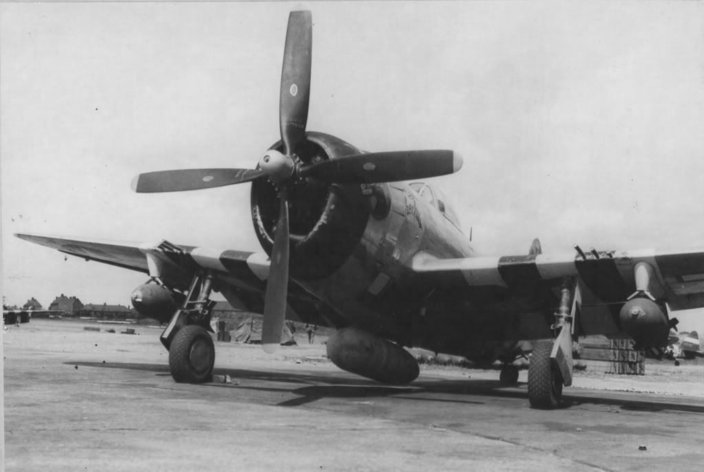

That is a Hamilton Standard prop on the front. Solid Aluminum blades as opposed to the Curtis Electric's hollow steel. Ham Std uses engine oil from the engine to operate the prop mechanism through a prop governor. The Curtiss Elect uses electric power regulated by a prop governor and sent to an electric motor mounted in front of the blades to change the pitch of the blades.
and the blades have a different decals on them!!! :idea: :wink: :wink:
DUH!
Thats how I can tell them apart :?
Rich

Here's the comparison shot!
The scholors among us will note the different decals :shock: :wink:

Note the Curtiss Electric also has blade cuffs at the base of each blade to improve engine cooling.
