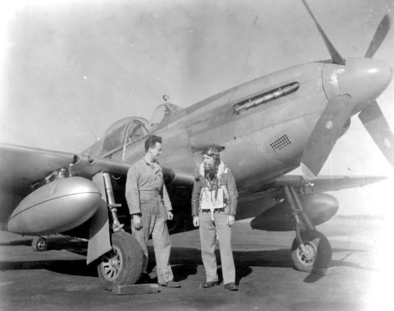

110 gallon type on a 361st FG ship
Martin

Swiss Mustangs wrote:110 gallon type on a 361st FG ship
Martin
I think those are 75 Gal tanks, they have a more streamlined look, compared with the 110 Gal one seen below, which nose is bigger thatn the rest:
Laurent
Tue Feb 19, 2008 11:34 am
The 110 gallon tanks do not hang level with the aircraft the way the 75 gallon tanks do. The 110 droops down in the front and looks like the spoon on a Bass Plug fishing lewer. The second pic above shows this and is why they look so ugly.
