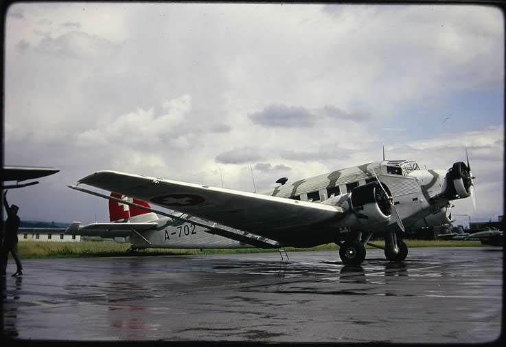

In the Movie "Where Eagles Dare" they used a Swiss AF original Ju-52/3m, coded A-702.... the paint-job was retained for many years after the filming.... (with Swiss markings reinstalled)
Martin
