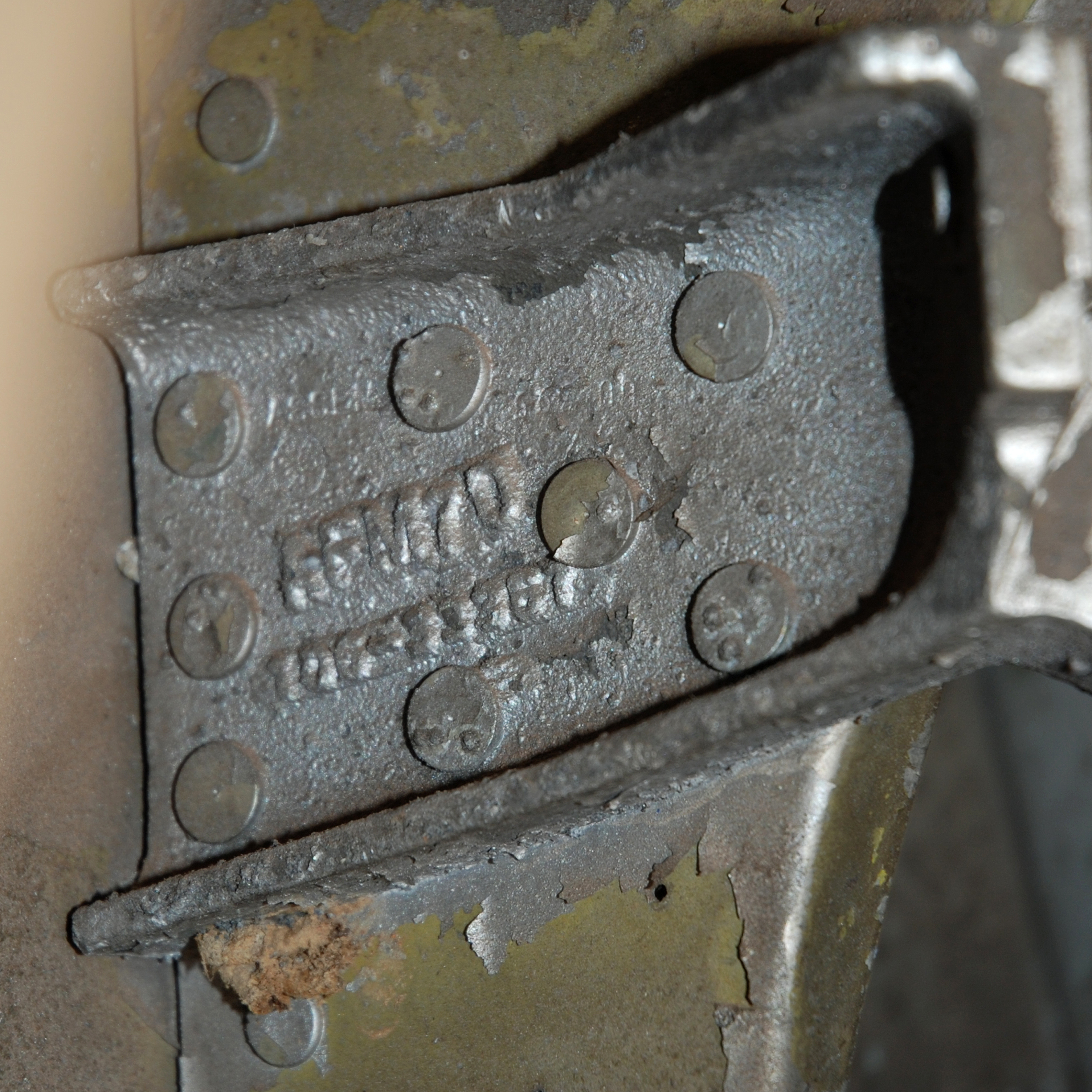

I was able to read off the c/n plate, that is, I found a plate in one of the mainwheel wells and the number does have the correct format of a NA Mustang c/n. However, it's weathered. I wrote it down as 186-33367, but perhaps it's more likely to be 106-32267 from the photo I took:
http://www.horizonten.nl/pix/plate.jpg
(large file)
Unfortunately, both the first and the second part of the c/n don't seem to fit in any of the P-51D/K serial batches, which Joe Baugher summarizes as given in the table below. Does anyone have a clue as to why?
Above the c'/n it seems to reads '.FM'70' (first character unclear). Is this a factory indication perhaps?
The aircraft is believed not to be a former Netherlands East Indies AF Mustang, but to have been purchased by Indonesia after 1950.

PostPosted: Tue Feb 05, 2008 2:26 pm
Posts: 3160
The number you have the photo of is a part number for that casting that is a part of the wing.
The serial number of the aircraft would be stamped or etched into a plate attached to the R/H longeron in the cockpit next to where the pilots shoulder would be.
There could be NAA construction number stamped in other parts of the aircraft which could correlate to a serial number.
Remember that almost every piece, little or big, has a part number. Some are stamped (pressed), some cast, some are inked onto the parts.
Also at some time the wing could be changed due to damage so that wouldn't be a good place to identify the aircraft.
Rich
PostPosted: Tue Feb 05, 2008 3:03 pm
Joined: Mon Jul 17, 2006 3:58 am
Posts: 25
Location: Amsterdam
Rich
Thanks for clearing this up, Rich.
I realized this needed not be the aircraft's c/n plate, but since the format was correct for a North American c/n I supposed it was.
Peter
