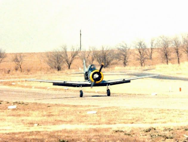

I found these pictures of a T-6 landing at Aero Valley in the mid 80's after the side panel had come off in flight! :shock:
Anyone know about this incident?
What airplane was involved?
What happened to the pilots underwear?

There are a couple of braces for the side panel that secure it to the tubular on the right side. On the left side the step holds the side panel. This has happened a number of times...someone forgets to put those braces back on at an annual etc, and someday the airloads etc, might force the side panel off. It has happened before, in fact there is a picture floating around someplace of one of the Kate replicas as the side panel is coming off in flight.

His name is Dave Dodd. He hangared right across the runway from me back then at Aero Valley. Basically, he was up doing aerobatics and got the plane a bit sideways. As noted above, the right side panel is held on mainly by a brace or two and seems they were either not connected properly or broke. I found one of mine broken and had to replace it, but did not loose the panel.
The plane was ex-Spanish and arrived in a crate and he reassembled it and repainted it. We often flew together in support of CAF and other DFW-area shows and events. I think I even have a video shot out of his back seat when we did a big formation flight over downtown Dallas for a Cotton Bowl game or something similar in the mid 1980s. If I dig up a copy of that tape, I'll see if I can digitize a bit of it and post a link here.

I forgot that what Dave said was the most uncomfortable thing about this was on landing as he closed the throttle, the exhaust flame licked around onto his right foot on the rudder pedal and he had to keep pulling his foot back. Aero Valley was/is only 25-feet wide at best, so use of rudder with any crosswind was pretty necessary.
If you have ever flown a J-bird at night, looking out the right side of the cockpit at the exhaust flame, especially on landing, is very impressive. Fly safe.
Randy

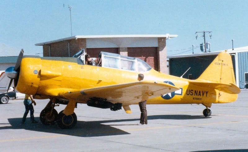

I just ran across this in my stuff...Look familiar?

Yep - that was my second SNJ, an SNJ-6 which had the gas guns in the wings and I added the bombs. I got to play like a fighter-bomber in some of the smaller shows and got to know and eventually fly with the Tora guys after some careful watching and practice. That really helped with I got into the FM-2 Wildcat and the A6M2 Zero.
Thanks for posting that and fly safe.
Oh, I found the VHS tape of the flight I mentioned above - turns out it was on 8 July 1984 over the Dallas Grand Prix. I think I leaned way out on landing back at Aero Valley and it gives a good idea of the runway there. I'll try and get something to share as soon as things at CAF HQ get a little less hectic with all the new folks, etc.

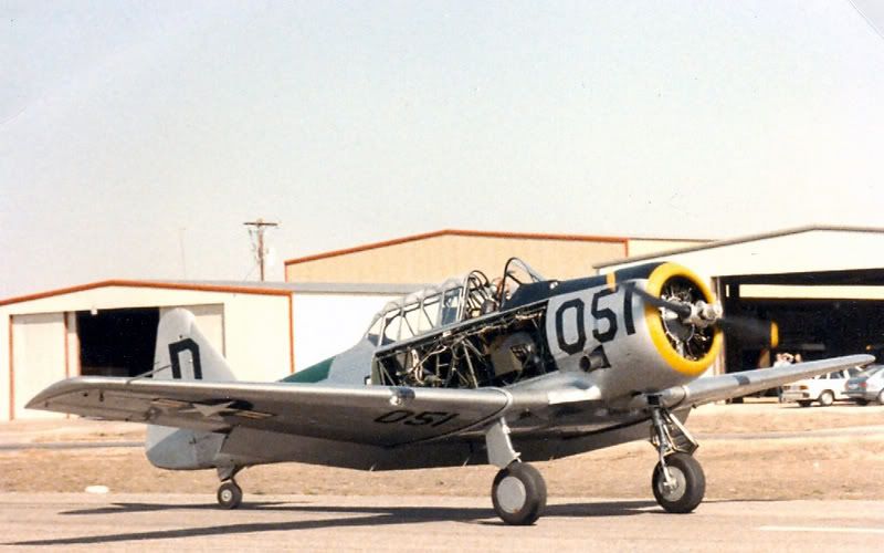

That photo was taken it Grand Prairie Municipal. Which reminds of something that happened there in the 80's. A Tora Zero (T-6) did a couple of test flights will all of the ring and accessory cowlings removed. I think they were trying to find an oil leak. It was an odd sight.
