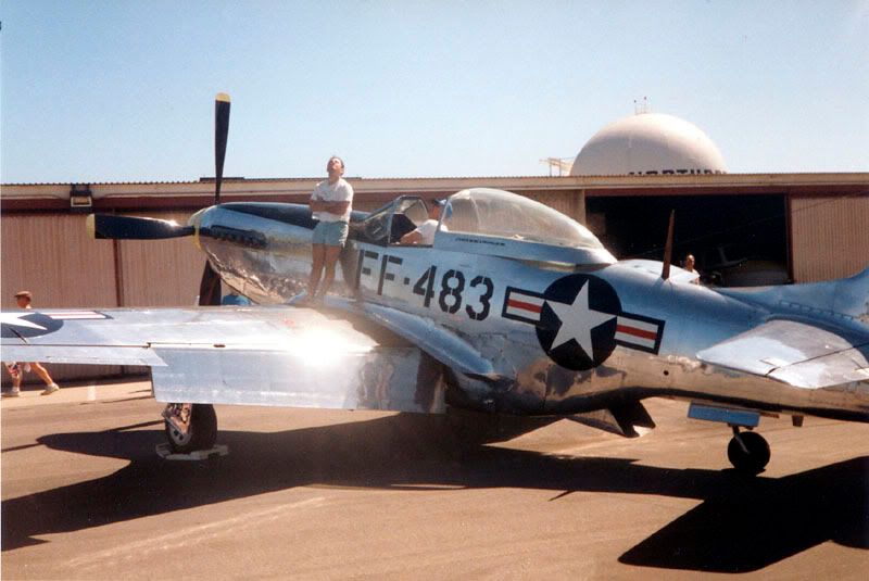

Hey Steve. Just looked through some photos and found this of your father (and you?) at the P-51D/ B-25 gathering in Hawthorne, CA in Aug. 1990. By the way, wonderful to see all the old photos you have uploaded in the albums.
T J
Make my day, punk!
