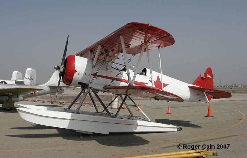

Aerial Pirate
Posts: 2002
This was the plane in the SRA Magazine, that was being converted to a Mdl 76. It was on display at the Chino show back in May of this year. As I recall in the article, there are issues with the floats that they used, that will keep this plane from ever flying off of the water.
Roger Cain
www.sfahistory.org
PostPosted: Thu Dec 06, 2007 10:33 am
The floats that Boeing used for them originally were EDO 3430's, which are a great handling float and are still very commonly used on Cessna 185's and 206's. The airline that I work for had a couple of Model 75 sprayers postwar and at least one was mounted on these floats.
