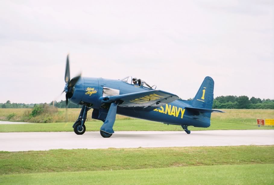

Ok gents, there is an ongoing discussion on one of the R/C boards regarding the color of the leading edges on Blue Angel Bearcats. Was it yellow, silver, natural aluminum, polished aluminum, or what? Does anyone have color pics or a reliable source confirming what was used? I am not, of course, referring to the all blue scheme but that which came a bit later. TIA

I don't know when these were taken but they both are forms of evidence
Trey
PostPosted: Fri Feb 17, 2006 5:25 pm
Posts: 775
Location: Arizona
Rob, I always assumed it was as you state, natural metal on the leading edges. However, the b&w pics that I've come across really tell another story. They just don't have the look of natural metal, unless it is a very dull natural metal (not likely I would think). They look more like silver paint to me. I guess I always assumed they were natural metal because most of the jets had natural metal leading edges. Beetle Bomb also has silver leading edges, not sure if they are paint or natural metal on that one either.
Trey, very nice color pic. Got one like that showing the later paint scheme?!

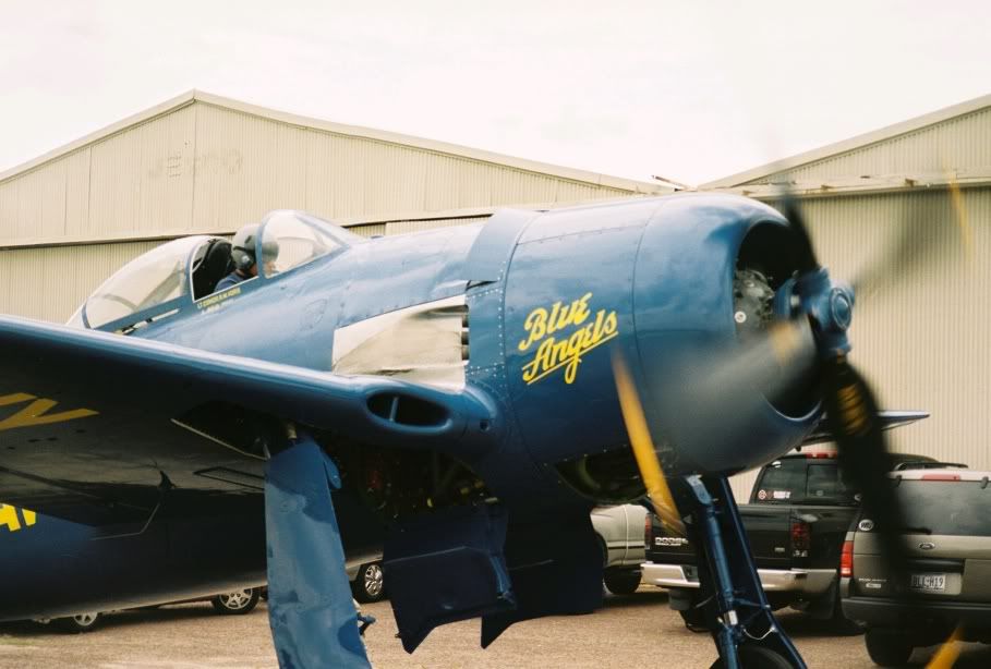

Ive seen them with and without a different color on the leading edge. I had a helping hand with the LSFM Bearcat. Personally like them blue.

PostPosted: Fri Feb 17, 2006 10:36 pm
Posts: 4437
Elroy13 wrote:
Ive seen them with and without a different color on the leading edge. I had a helping hand with the LSFM Bearcat. We didnt paint the leading edges because we couldnt determine the right color. I personally like them blue.
Elroy, thanks for the photo's of Gumby the Bearcat driver...

PostPosted: Sun Oct 28, 2007 7:14 pm
Joined: Fri Oct 26, 2007 1:55 pm
Posts: 1
Location: Evansville, Indiana
I collect on the Blue Angles, however only the Grumman F8F Bearcats they flew.
From Lynn Mc Donald, retired Historian for Grumman, I found that the leading edges of the Blue Angles' Grumman F8F Bearcats, as well as the Grumman F9F Panthers, etc., , was a product known as Corogard, a very tough coating which stayed on the applied surface, even if it was a high rate of speed.
Corogard was pioneered by Grumman and came in Aluminum and Red colors. It was the Aluminum color Corogard that was applied to the leading edges of the Blue Angles' Grumman F8F Bearcats.

PostPosted: Sun Oct 28, 2007 7:22 pm
Posts: 1715
Location: Safford, Az
Gumby better not fly too far with the lower cowling removed :wink: !
He was just doing some taxi tests. :)
